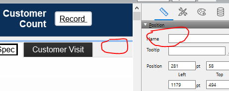

In Positon, the TAB control is the only name I am able to edit.
when i select each tab in the tab control, the name is grayed out so i can not edit or add a name

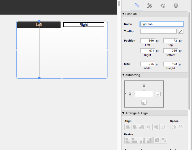

Make sure the tab panel is selected (click on it again, if necessary).

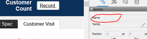

when i click on it again the tab control is selected and not the individual tab which i need to add a object name toimage.png.26083d71f5592e206012a443f1658253.png

I am unable to reproduce your problem.
ok apologies, by clicking on it again does activate the name even though the control tab is highlighted.
