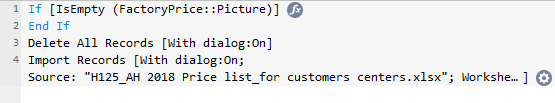

Thank you, but it does not seem to work.
I have 152 records, i have a picture in one of the records, when I run the IsEmpty scripts, all 152 records are deleted.

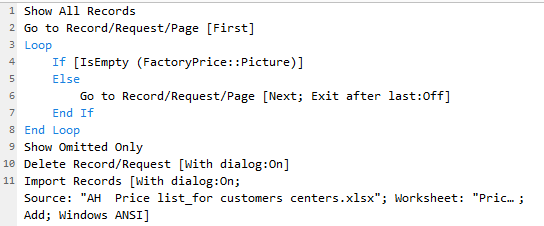

I tried below script but stays in loop.
Here is my script:
Your script looks nothing like what was suggested.
I have tried the code as suggested, but as I said, It remains in the loop and nothing else happens.
It is not deleting the records.
You have to be more meticulous with your coding. You have:
Go to Record/Request/Page [ First ]
inside the loop, where the example script has:
Go to Record/Request/Page [ Next ; Exit after last: On ]
so of course the loop never exits.
Also, you are omitting the empty records, not deleting them. If you want to delete them, then - after the loop has terminated - switch to Show Omitted Only[] and do Delete All Records[]. Or delete them in the first place while still inside the loop. What you have now will delete one record - and that record is not empty (or it would have been omitted).

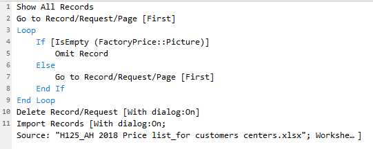

I have made the changes as suggested, it still remains in the loop.
I am sorry to say this, but this is getting ridiculous. You have no action specified for when the If[] condition returns true (it should be Omit Record). I said before that you need to pay more attention to detail. You have a perfect example given to you in the help, yet you can't follow it. I will not continue playing this game.
