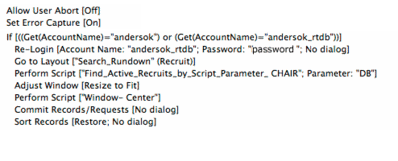

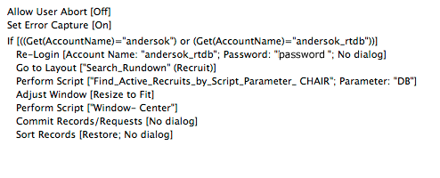

I've attached my script.. could someone take a peek ?
Add a Show Custom Dialog step with Get(AccountName). It would seem the account name test is not successful, but putting a dialog step in will verify if it's getting past it.

I'm curious why you're re-logging in as andersok_rtdb if the account name is already andersok_rtdb though.
I'm relogging in because I"m authenticating against active directory, then relogging in to assign more specific privileges
