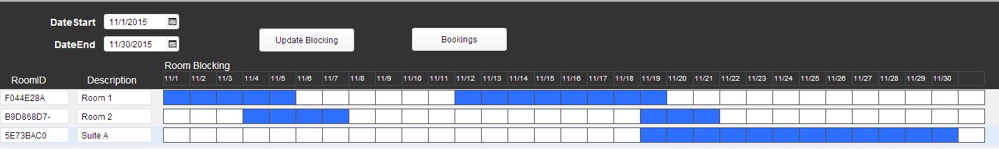

I've attached a quick and dirty example, using method 2. Let me know if this is what you're thinking about. (Note: I could probably make the SQL queries a bit more efficient, but it's simple enough to show how it's working in the loop)
5644f8d386c82_BookingBlock.thumb.JPG.6b5
Booking.fmp12
Booking.fmp12
Edited by GisMo
Updated Scripts in sample file for account for last day in search range
