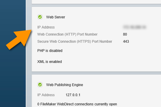

16 hours ago, Rick Whitelaw said:
On the status page there is no indication. I only discovered this by editing the deployment. Nor can I find a fsadmin command to start the web server.
The web server status is indicated on the status page (see screenshot).
The web server is not part of FMS though so there is no "fmsadmin" command to start or stop it.  The only thing you can control from an fmsadmin command line is the web publishing engine:
fmsadmin start/stop/restart wpe
To control the web server itself you need to work with the "apachectl" command line.
