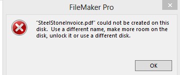

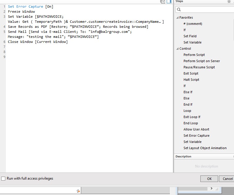

Hi tried to send out email with variable pdf.however i get the attached error messageScreenshot.jpg.c598f5834c9d1fc3cd4cc6a96
My script is as follows
Screenshot.jpg.f42952b2d29fd3dc77eec215a
Any idea where i am going wrong and what is causing this error.
p.s THe button is on the record i ewant to attach
Can't see the full script step, but do not use . in a table occurrence name, but rather an underscore.

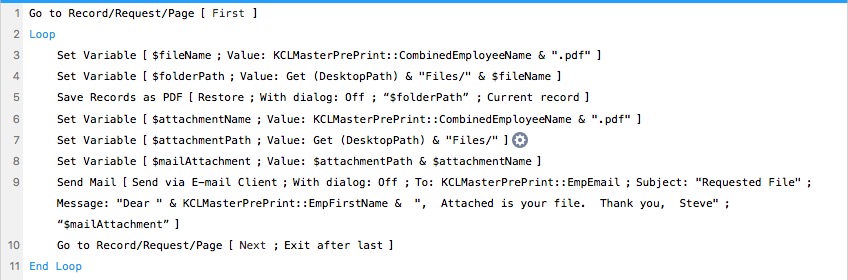

Everything works except there is no attachment in the email that is sent. Here is my script. What am I missing?

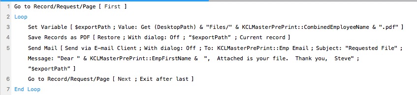

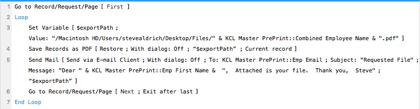

Use Get (DesktopPath) & "Files/" &  KCL Master PrePrint::Combined Employee Name & ".pdf"
Just a suggestion, spaces are not your friend. Use underscores in table and field names.
No joy. Still no attachment in the email.
Do I need to specify different paths for saving the file and then for retrieving it to email?
Here is the script after making the changes you suggested (assuming I did it right).
It looks like to key might be setting more variables. Thanks for the suggestion, BruceR. I'll give it a try first thing Monday.
"It looks like to key might be setting more variables."
It isn't strictly necessary. But sometimes it can help clarify your thinking about what chunk of code does what.

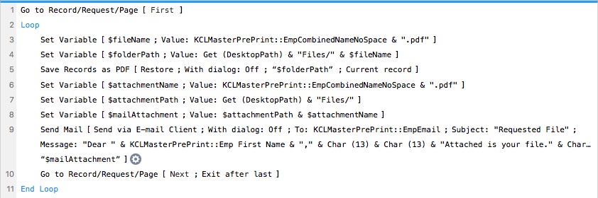

Thinking the mail process might need new variables other than the ones used to create the file in the first place, I came up with the following. But there is still no attachment in the sent email. My guess is the issue is somewhere in the path for where to get the file to attach to the email. I thought it might be because the file wasn't saved to the folder yet when the Send Mail command was invoked, but adding a Pause didn't help.

What is the value of $filename? Does it contain a character that is causing the path to be invalid?
You may be onto something. It's the first and last name of the intended recipient. With a SPACE in between! Let me replace that with an underscore and try again.
No luck.
Even after I took it one step further. EmpCombinedNameNoSpace is the recipient's first and last name with nothing in between. So, an example of the name of the file saved to the folder would be "JohnSmith.pdf". Which means the path to the file should be /Users/Me/Desktop/Files/JohnSmith.pdf for both saving and sending the file.
Do the requirements for the path syntax for Send Mail differ from those for Save Records as PDF?

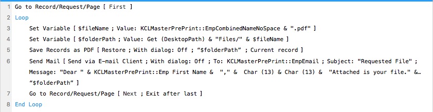

Here is my current script.
No, creating the path is identical. Are you seeing pdfs in the Files folder? You could simply this by writing them directly to the desktop. I actually use Get (TemporaryPath) for this.

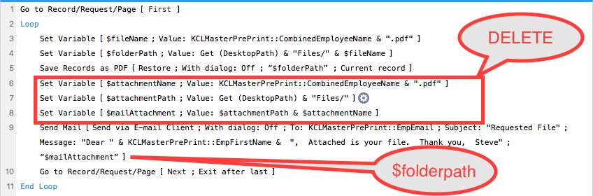

Well, it appears that the thinking was not clarified.
You have established the full PDF path once. That's all you need.
That makes sense. But it looks like I'm back to the first revised script. And still no attachment in the sent email.

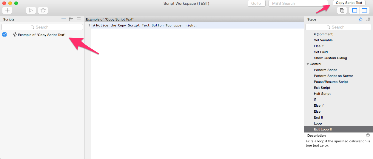

It is so simple in 14 to do this. Select the script in the Workspace and the use the button at the top right. Copy to Text, and the paste the result in your Body of the post.
Lee Smith, I don't see a Copy to Text button anywhere on my Script Workspace screen. Is it because I am using FMPA 15 now? Sorry, I forgot to update my Profile. (I was quite confused about this since your screenshot didn't appear at first for some reason. But that Copy Script Text button is not there in my Script Workspace.)

I don’t have version 15 so I can’t verify this. Perhaps they changed the button?
The old fashion way, is to print to Preview and then copy and paste that to your post.
That's odd. I still had FMPA 14 on my computer, so I tried that - and still no Copy Script Text button. Print > Open PDF in Preview worked though:
