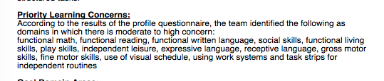

It works! The relational database option, although out of my league, seems like it might be important to learn about. I have output based on user input that guide users to certain options, so it might look like this.
