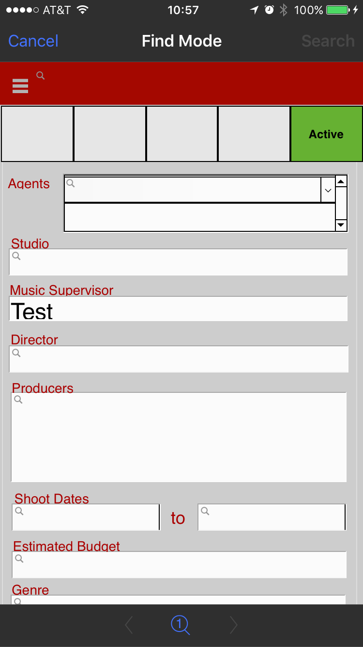

I'm running FileMaker Go 15 on iPhone 6 (iOS 9.3.2). I had this same issue on FMGo 14 before I upgraded.
When I click Create New Find and enter find mode, I enter data into the fields I'd like to search, but the "Search" button in the top right corner is grayed out/unavailable and clicking "Done" or "Go" in the native keyboard doesn't perform the find. I've attached an image in find mode so you can see what I'm talking about. I even have admin privileges and it doesn't work. The Quick Find search seems to be the only thing working.
Any insight would be helpful! Thanks in advance!
Arbel
Try exiting the field to see if it allows search then. It looks like the Agents field is possible selected.
Unfortunately, I've tried that. No field is selected :/
