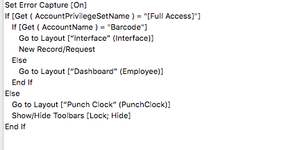

My Script Steps: (This script is triggered "OnFirstWindowOpen" Trigger)

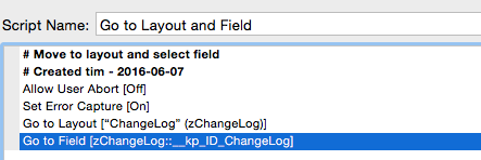

Well, my experience differs from yours then - the following definitely works for me:
This works fine when I don't put the new record script step on firstwindowopen trigger and put it on onlayoutenter ...
