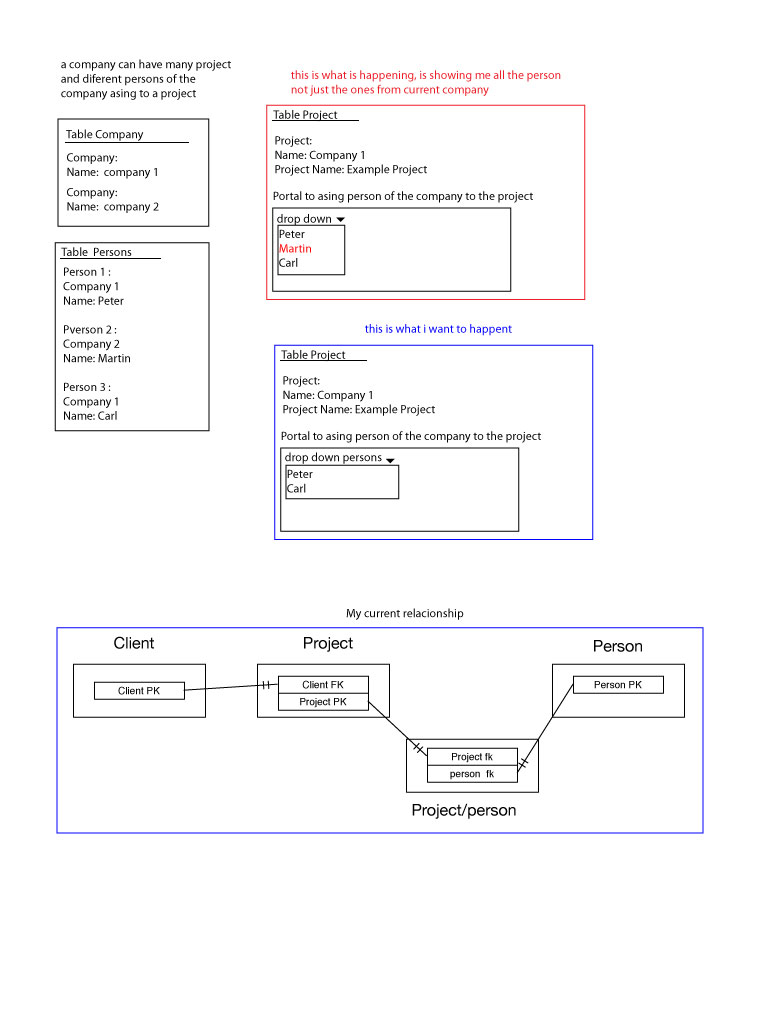

Hello i'm new in FM, i making a data for my company, and i have a problem i been like to 2 days try to solved with out any luck, i have 3 tables:
the company(table "company") can have many projects (table "projects") and the projects can have many person in charge (table "in_charge") and i have a 4th table "project_incharge" in other to add specific  person to specific project so far i got the picture clear the problems is wen i add a portal to the projects table, and to a a record to it from the people in charge i just want to see the people charge for the current client, but i see the list from all the client in charge.
so the idea asigne some in charge people to a specific  project  that work for a specific client, not all the in charge for all the clients i hope i make my self clear.

Thanks i just attach a diagram of what i want to accomplish i hope is much clear now, thanks again
Do I understand this correctly:
  • You are on a layout of Projects table;
  • You want to assign another person to the current project;
  • You want to use a value list showing only persons that have already been assigned to any project of the client that owns the current project.
yes  !!!! thats it

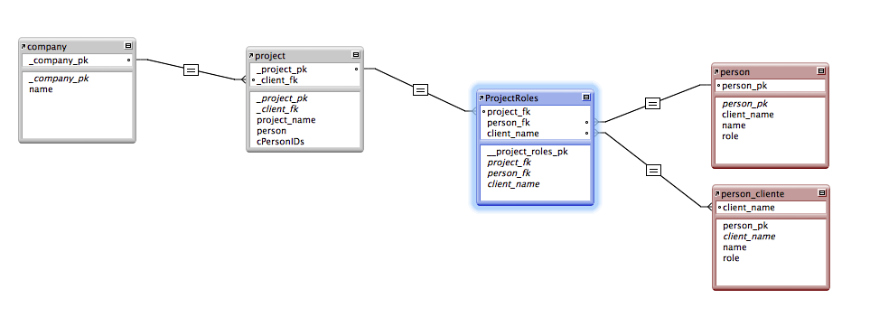

You've skipped item #3.  Also, if a person can hold different roles depending upon the Project then the field 'Role' should be in the join table (ProjectRoles) along with the ProjectID and the PersonID instead of in the Persons table.

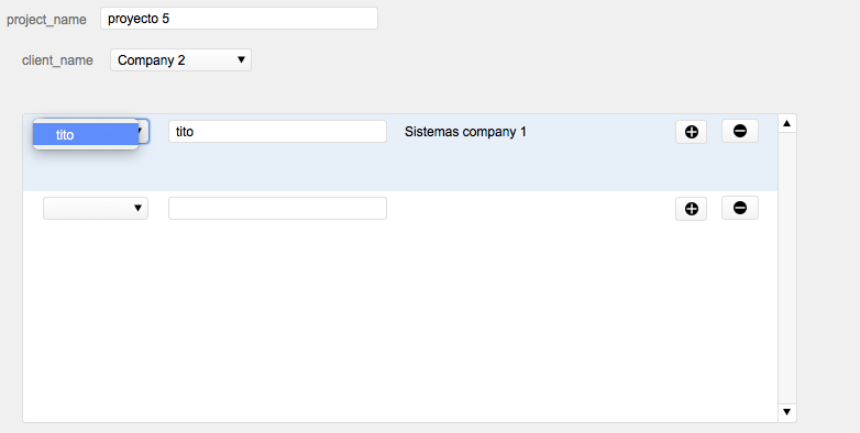

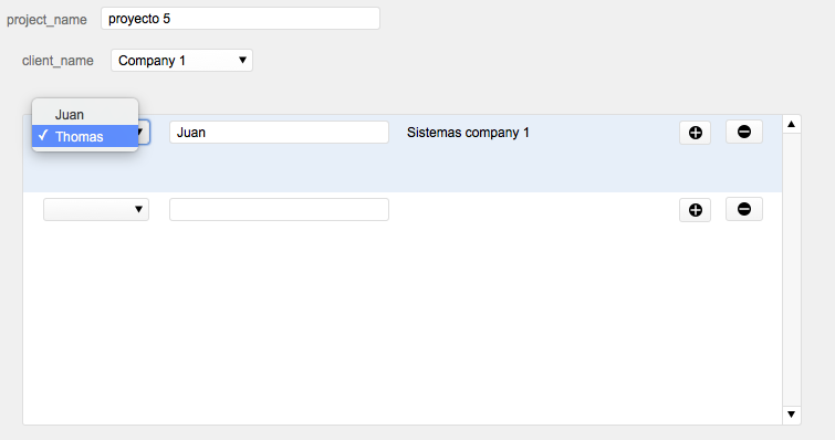

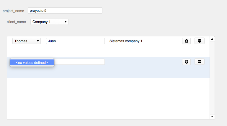

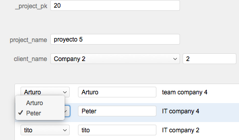

OK i solve the issue of showing only related person from a current company but in the portal i just can add one row, how can just select one client and let me any more than one person to the portal

1. You didn't follow any of Comment's directions. You created no list of existing project people.
2. Your planned approach will work; but it does not allow you to create project roles for a client that has never had any projects before.
3. It does not allow you to add new people to a project; people who have never before worked for any project of this client.

i think  solve it .... i
i add i dropdown menu from client_pk with this i add to the project the client that ones the project
then i add (+) BUTTON in my portal  with this script
Go to Object [ Object Name: "Portal" ] Go to Portal Row [ Select; Last ]
Set Field [ ProjectRoles::client_name; project::_client_fk ]
Commit Records/Requests [ No dialog ]
so i add new row with just the person from current client ...
may be is not the best way, i'm open to improvements :) thanks all for you help and ideas....

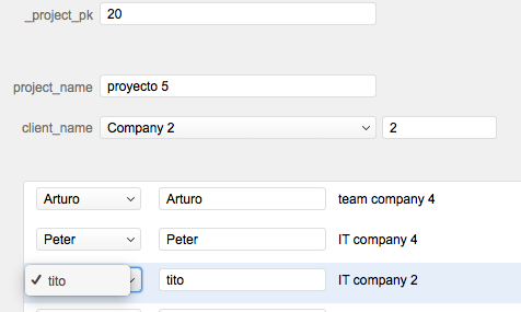

Doesn't work at all.
Doesn't properly present people in value list.
Also: Role field does NOT belong in Person table.
If the Role field is in the Person table that that person has the same Role for every project they are assigned to.
