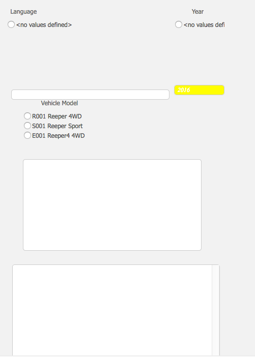

I have a FileMaker server 13.v10 database solution that changed somehow during development and now does not display several WebDirect objects properly.
For starters, the text shows up as white on a white background, which it did not do before.  We have been and are using the Cool Grey theme.
Other problems with display:
1.  3 value lists will not display:  One a regular list from a set of values, another list from a related layout, and a third a filtered list from another layout.  Another value list works normally
2.  A picture in a container field (locally stored, not external yet) does not show.
3.  A filtered, sorted portal does not show the records, nor are they accessible in the portal. The filtering and sorting are straightforward.

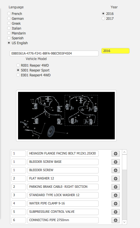

Everything works fine using FM client.  Only WebDirect has problems.
A photo showing the problems on WebDirect is attached, as is a photo showing the fields properly displayed in FileMaker Client.  Please forgive the look and feel; the photos show the layout as we made changes and are troubleshooting.
