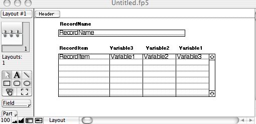

I was hoping to develop somthing that looks like the attached image. The image is roughly the way I want it to look, but the variable fields are all independant and don't scroll together as I would like. As the number of items is unknown and will change as the DB grows, repeating fields doesn't seem the way to go either (unless I wan't to keep updating the Field format--which I don't).

Your image looks like a portal?
You don't need a second file to have a protal, use a self-relationship and create your portal based on that.
Hi, c! I agree w/Lee and you should be able to get pretty much exactly what you want with a self-join relationship and the just drop your desired fields in the portal. The portal will show all applicable records as they are created/edited immediately in the portal.
