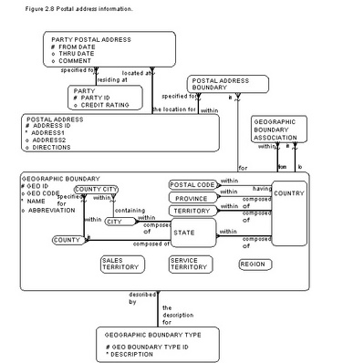

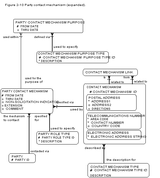

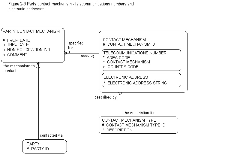

Many thought leaders in Data modeling (David Hay, Len Silverston, Graeme Simsion) have already developed logical abstraction models for a Supertype of phone number, which is called a "Contact Mechanism" for a party. There is usually a Contact_Mechanism_Type entity, which in FileMaker terms (PHYSICAL MODEL) would be a table serving as a value list, in data modeling terms a value list is called a domain.
Other contact mechanism types are web address, email address, fax number, physical address, postal address, etc. There is usually also a relation to a Contact_Mechanism_Purpose entity. If someone is interested I can put up an image of the model.

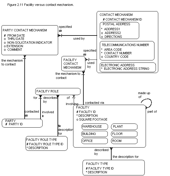

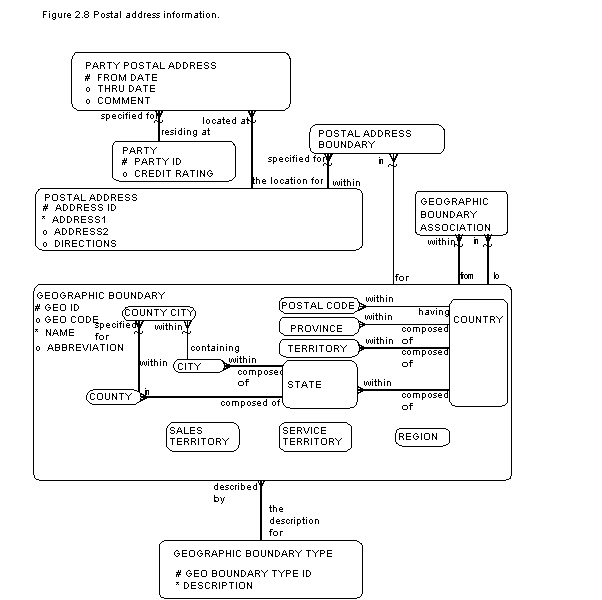

Well, some say it depends on what the Address (contact mechanism) is about, the semantics that is, if it is a physical or facility LOCATION then that is usually expressed as a GeoCode Location, (Geospatial Entity Object Code, a hashcode for a precise longitude, latitude, altitude and other info required to locate a point on the earth) which allows GIS map positioning, and a relation to a Facility entity. So then the purpose would be GEOcode. A GEOcode can have a relation to a postal address, if the GEOcode location receives mail, see diagram parties 2.8 in a follow-up post. The models are from Len Silverston, "The Data Model Resource Book, Vol 1", highly recommended.
Other purposes could be:
  • Postal address, as a building (for example one that takes up a whole block) might have several street addresses but the post office might deliver mail to only one. That is also a relation to the Facility.
  • Freight Address, where there might be a loading dock or freight receiving area that could be defined with a purpose Freight Shipping and/or Freight Receiving.
  • Visitor Address, there might be a Reception or Visitor Entrance address purpose.
  • Employee Address, an employee entrance address purpose
  • Emergency Response Address, which could be the address given by a 911 call.
Thanks Lee, yes theory would be the WRONG place. I guess the precise term would be Logical Data Model Discussions.
Here are the additional diagrams for Postal Address Info and Party Contact Number.

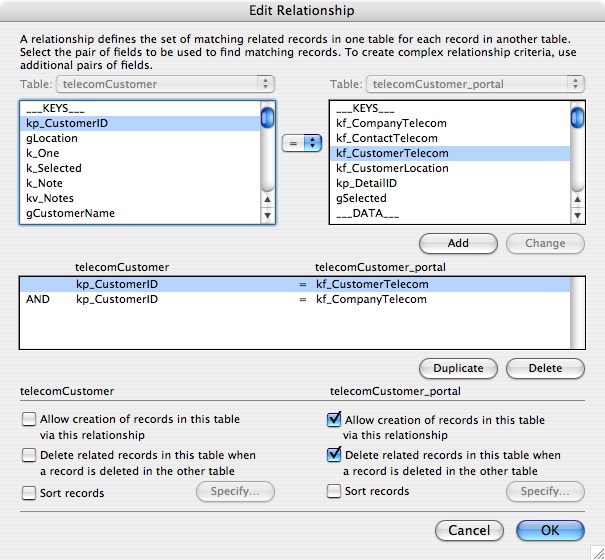

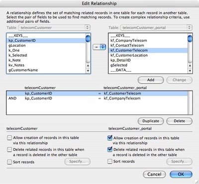

In my "Details" table that stores addresses and telecom data (email/web/phone/fax)
for each data type that I wish to access by type just include a new key in the details table.

Also nothing prevents you from using multi-predicate equijoins relationships between your contact table and your detail table as in the example here...
Then you can if need be find ALL detail regardless of type by contact/company...
if you notice I have the same field on the left side but populating 2 fields on the right side.
