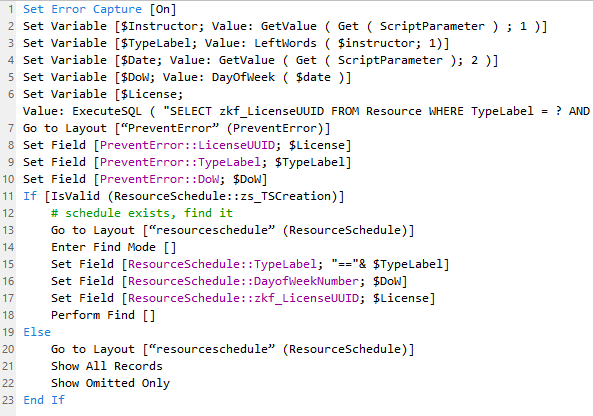

Do an ExecuteSQL to do a quick select, if that comes up empty you can skip the real FM find.

Or use a relation to check if the found set exists.
