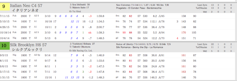

I have not explained myself well, so I am going to give it another go with pictures. I've creating a nifty racing form -- actually, you have. Anything other than the basics was supplied by members of this forum. I have a completed product, but the speed rating is tediously worked out in Excel.  Here is a picture of the result.
finalproduct_example.thumb.png.30f6d7013

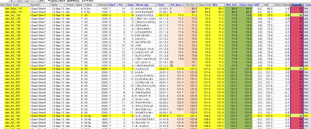

The columns with the red 82 in Italian Neo and the red 83 in Silk Brooklyn are the speed figures. I get those in Excel through some calculations that involve race averages and class averages. I have reproduced the numbers in FM in a summary report. But first, it might help to show you how I receive the data in Excel:
Excel_sample.thumb.png.37bcdee9fe16cf120

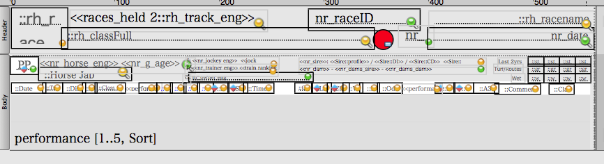

What I actually receive is from columns Date to Time (I left a few things out as they were not essential for this problem). On the right you can see 'Class Speed' which is the magic number I need in the form. Here is the layout:
FM_layout_sample.thumb.png.a13c152aa45b2
The portal is everything - the past performances which are of course sorted by date. As I said, I reproduced the speed rating via the summary report using GetSummary in the calculation, but I can't use the speeding rating in the portal.
