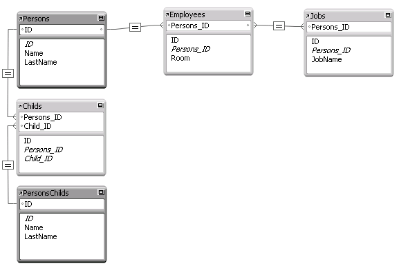

im searching for a solution which will let me save the relationship history of records. I want to have something similar like a "snapshot" of every record if it gets modified.
in my example i want so save which employee had which jobs and childs over time, so i can view the past history of a specific employee.
I understand the jobs part, but not the children part. People don't have children "over time". With regards to jobs, your solution seems fine - assuming that you want to add jobs from a layout of Employees, and assuming (based on your previous question) that the relationship between Persons and Employees is one-to-one.
I would add StartDate and EndDate to the Jobs table. And I would validate PersonID in the Employees table as unique (this will make your graph clearer).
This is assuming you are not tracking Positions.
In my example, we need to track the childrens of persons until they get of age, so you are right anyway, i can simply add an Start- and EndDate to every table.
yes, the relation between persons and employees is one-to-one. But there is a new "problem". If some person change his name, we need to track the old one. (so i think, i need an one-to-many relation here?)
So, i dont need an unique Employees.ID field, only the Employees.Persons_ID Field as unique field?

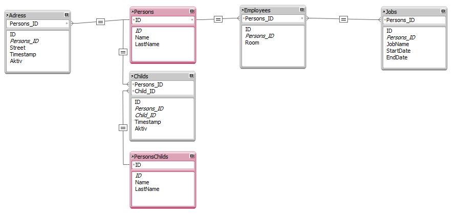

here is my new database design.
now i can track which Person has which childs, and if the child is of age i will set the "Aktiv" flag to 0.
same for adress, if a Person have a new adress i will set the old one to "Aktiv" = 0 and enter the new adress with "Aktiv" = 1.
for the jobs i have added an Start- and End Date.
How can i track changes of Person names or changes in the Employees Table?
Hi Marc,
You still have not set PersonsID to unique in the Employees table.  I know this because you have a fork on the end in your graph on Employees (both from Persons TO and also on the other end from Jobs TO) which indicates multiple same PersonsIDs are allowed in the Employees table.  So first, I would make that change, making PersonID unique in Employees.
As for tracking Employee Room and Persons LastName history ... I see no reason that you can't have same setup as your addresses, namely a table off Persons called NameHistory and one off Employees called EmployeeRooms or PersonRooms - either would work.
What if the business wants to then track first name change or other bits of person information or employee salary history, for example?  You can also just use a table called History with unique ID, PersonID, ActionDate, Type (address, name, room or fieldname) and prior value or you can use an actual audit table.  A Google search will provide many examples such as this one: NightWing Ultra Log.
Comment may have other ideas.  I suggest that you discuss the requirements with management and then choose best method based upon the possibilities you will need, otherwise they may ask for you to track history on additional details next week or next month and you'll be changing/expanding the structure to accommodate as you've had to do here with the new fields Room and LastName.
Personally, I would not have a Childs table at all.  People are people.  But then again, much depends upon your needs ... you can have a field ParentIDs with multiline of the mother and father and self join the relationship.  Otherwise, what if the child grows and becomes an Employee or a parent?  Without knowing more about your business needs, we can't give you these answers - only point out that the questions should be asked first.
Now i understand, what you mean with the unique ID, because Persons to Employess is a one-to-one relation. Thank you for the hint with the fork, i didn't see that before.
