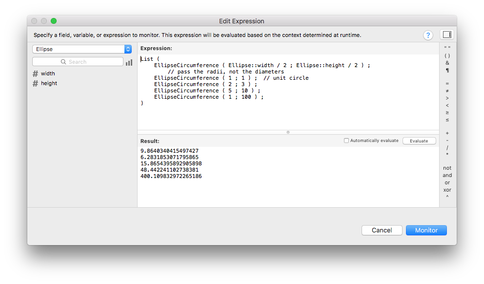

I realized the potential confusion with that this morning and re-named the parameters to "radius1" and "radius2". You should be passing ( width / 2 ) and ( length / 2 ) as the parameters (the order doesn't matter): EllipseCircumference ( width / 2 ; length / 2 ) -

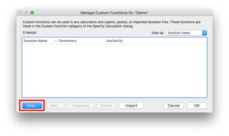

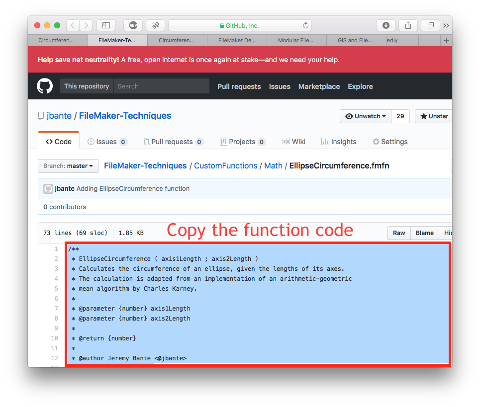

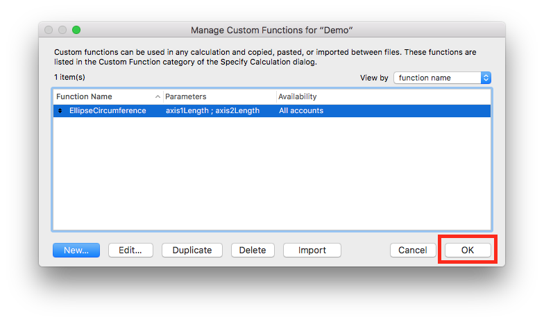

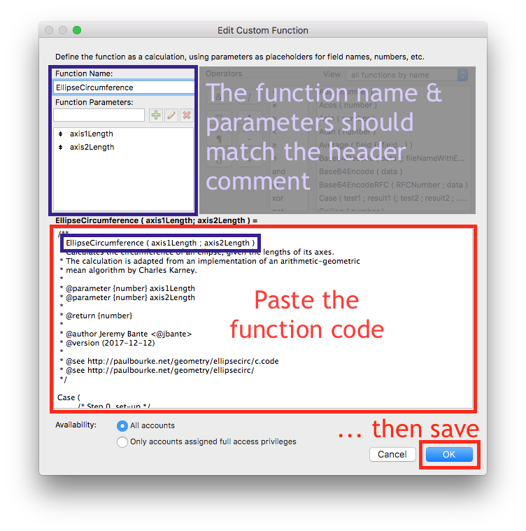

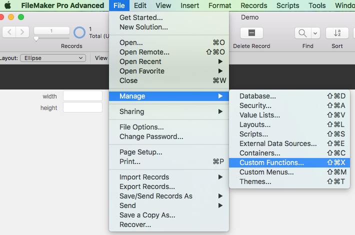

So you're asking about how to copy my calculation into your file as a custom function? FileMaker's help documents how to make custom functions in general. Copy the calculation code for the EllipseCircumference custom function from GitHub. Open your file in FileMaker Pro Advanced. Open File > Manage > Custom Functions... In the "Manage Custom Functions" dialog, click the "New..." button in the bottom-left corner. In the "Edit Custom Function" dialog, paste the function code into the function calculation box. Set the "Function Name" and "Function Parameters" to match the header comment in the function calculation. Click "OK" in the "Edit Custom Function" dialog, and click "OK" in the "Manage Custom Functions" dialog to save the function. You can then use the EllipseCircumference custom function in any calculation (field, script, data viewer) in that file. The approximate calculations mentioned earlier in this thread are all wrong, by about a factor of two. The first reference link in the thread gave an incorrect formula. The correct form of the approximation is: 2 * Pi * Sqrt ( ( radius1 ^ 2 + radius2 ^ 2 ) / 2 ) (Or diameter/2 in place of the radiuses.) This approximation is exact when the axes are equal (i.e. for a circle). The relative error of this grows up to about 11% as the ellipse gets extremely stretched out. This is a much better approximation (now also available in custom function form), if you really want a simple formula instead of the more exact custom function: 4 * ( radius1 + radius2 ) * ( Pi / 4 ) ^ ( 4 * radius1 * radius2 / ( radius1 + radius2 ) ^ 2 ) This approximation is always within about 0.1% or better. Still, I'd only use this if the exact calculation is too slow for a particular application. -
