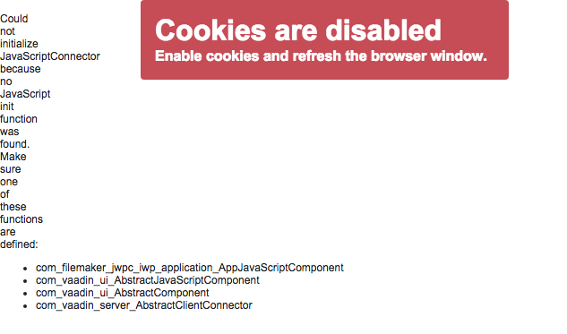

Hi, I've just installed an SSD into a Mac mini server and done a fresh install of macOS Sierra. I installed FMS16 and ran the updater to bring it up to version 16.0.2.212. When trying to access the sample database over WebDirect, I get an error about JavaScriptConnector and a big, red box complaining about cookies. See the attached image. I'm using the latest version of Chrome, and cookies are enabled! Shouldn't the FMS16 installers have installed all of the necessary JavaScript files that it needs? What gives? Anybody else have this error? Thanks!
