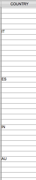

I have a Layout in Table Mode as (partially) shown in the attachment.
(Note:  First row will have a Country Code in it - not shown in attachment)
I want to "fill-down" the last country code in all rows (in the Country Field) UNTIL the country code changes.  Then I want to similarly do it for that one.  Until I reach the end of rows.
My database will grow from 500 to 10,000 rows of text/number data.  I am uploading in batches from Excel.
Is this possible?  I've tried various calculations and scripting without much success.  Thanks!
I'm trying to get something like this:
COUNTRY
IT
IT
IT
IT
IT
IT
IT
IT
ES
ES
ES
ES
ES
AU
AU
AU
AU
AU
IN
IN
IN
IN
.......etc
