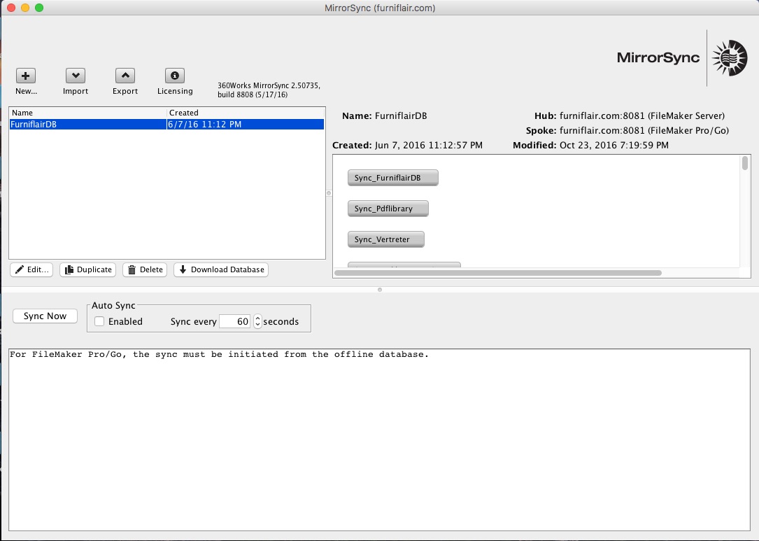

Sorry but I cannot find the Report a bug on the Mirrorsync Client page. Am I in the right place? :baby:
It's not inside the MirrorSync config client, it's on the page in the browser with the big blue button that launches the config client. The URL is http://yourserver/MirrorSync
