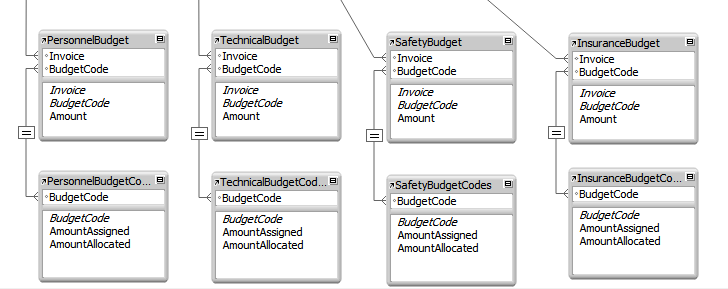

To my query now;  I have designed a solution for my company which processes invoices.  These invoice forms input numerical amounts tied on budget codes for each department and in turn are stored in a different table.  As you can see on the image attached, I cannot find a calculation function that will sum all the amounts for each BudgetCode into AmountAllocated.  AmountAssigned is the yearly department budget predefined.

Care all of these 'budget' Table Occurances based on the same base table?
Same question for the 'budget code' TOs.
Yes Wim, those are all connected to the main Invoice page and the only common link is the Invoice number.  As for the Budget Code tables, at first I thought of not linking them and calculating them via script but I cannot figure out a command that will give me the flexibility of an SQL query.
I don't think I understand your answer in relation to my question...  If 'budget' and 'budget codes' are just one table each then it should be fairly easy to set the 'amount allocated' to the right value by using any of your existing relationships.  sum(personnelBudget::amount) for instance will do if you execute the Sum() from the context of the 'PersonnelBudgetCode' TO.  Given that all of the relationships between budget code and budget are duplicates you can pick any one of them as long as start from the TO used in the relationship.

I don't think you need a new table occurrence for a different budget type (budget code) you just need a type/code field.
Also you should use an ID (primary and foreign keys) to connect table occurrences.

Well...silly me, I confused myself for the wrong reasons.  Wim, the Sum calculation worked like a charm in the AmountAllocated field due to the relationship I have created.
