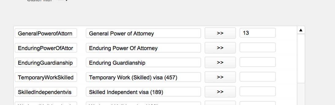

I have a FileMaker layout with a portal to another table. The relationship shows all unassigned records (related < 1). On each portal row I have a button which runs a script. The idea is that when you press the button the a value from the main record is copied and pasted into a field in the portal row (and as a result the portal record becomes 'assigned' and is removed from the portal.
I have the button running a script and pasting the value from the main record but it is pasting it in the first portal record, not the one whose button was clicked.
Is there a simple way of having the value pasted into the portal record where the button was clicked or do I have to store the record number (or something) and paste back to that record?

Why don't you post your script, so we can see? Offhand, I would say that a simple:
Set Field [ Related::SomeField ; Main::SomeValue ]
should suffice; as long as the button is in the portal, this will operate on the related record shown in the portal row where you clicked.
I was doing a bunch of copy and pasting etc but Set Field works first go. Thanks.
