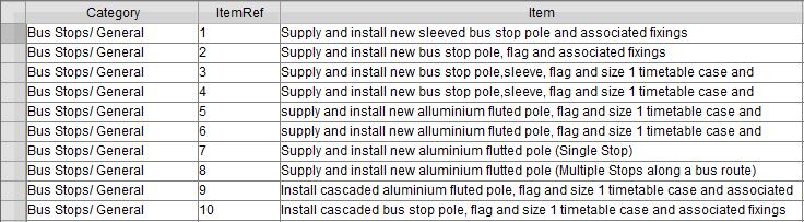

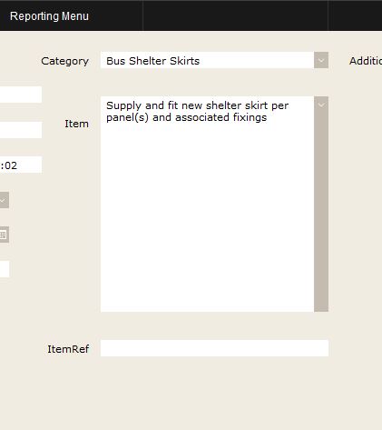

Please see attached examples. I attach sample of the table, and a sample of the layout. In the layout the "Category" chosen does now create a relevant value list for the "Item" field. If you notice below the "Item" box is a "ItemRef" box, I would like that to show the "ItemRef" for the item, "ItemRef" is also a unique number.
Mike
I suspect I need a script to run on Exit of "Item" box to refresh the ItemRef cell.
Or make ItemRef lookup the value from the subtable as an auto enter option, or simply show the now related firld from the subtable - Category::ItemRef
