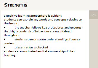

I've got a form that using check boxes to update a summary text box with information based on which check boxes have been checked.
However, if one is checked in error and then unchecked I would like to remove the text from the summary text field.
I've tried to use the Substitute the text with just a blank and all it seems to do is keep the text but put it in lower case. I had bullet points but then removed these to see if that would help but didn't
I'm not sure where to go from here. Ideally I would like to keep the bullets but if they need to go that fine.

Thanks school boy error. I fixed that. However, it still doesn't want to work.
The text within the variable isn't encased in quotes and the substitute needs it to be (tested it with the actual text ). HOw do I get the text to encase in quotes whilst using it in the Substitute string?

Thank you. I've tried that but it doesn't want to work.
Substitute ( HoDObservations::Overall_Strengths ; "\"" & $DeleteText & "\"" ; "" )
this is the text in the box
A positive learning atmosphere is evident
Students’ pride in their work is evidenced through presentation and work rate in books
Students are motivated and take ownership of their learning
· The teacher follows KBA procedures and ensures that high standards of behaviour are maintained throughout
· Students demonstrate understanding of course content
