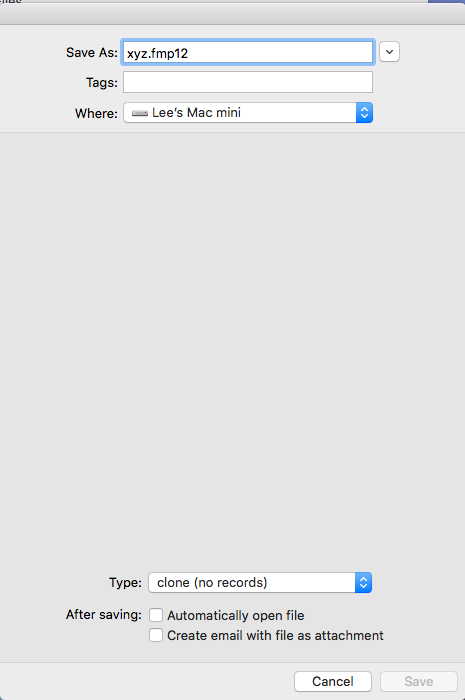

Can you post the script or a clone of the file?
Hi docasar
or
Save a copy as »» clone  "no records of the file.
