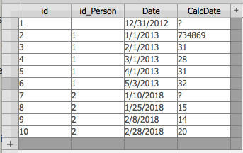

Hi, I am using this calculation in portal which calculates days in portal  Date - (GetNthRecord ( Date ; Get ( RecordNumber ) - 1 ) )
how can i modify or do something else to avoid (?) in the first row.  Sample file attached for any modification/help.

It is getting an error on the first entry for each ID where there is no Nth record to get the previous date from.

yep thats the problem. is their any other calculation to get days between dates in portal rows.  something like which starts calculating from second portal row and ignore the first row or put the calculation in second row.
some calculation like    ....Calculate the days between portal rows and don't calculate the first row or blank if dates are same.

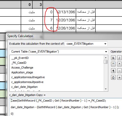

Thanks Aussie John for help the case statement solved the problem here is my screenshot of original solution (the dates are local i mean not Gregorian calendar )
