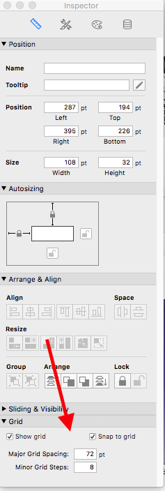

To Verify that you are working with the grids on or off
yes, these are my settings. grid is 72/8
