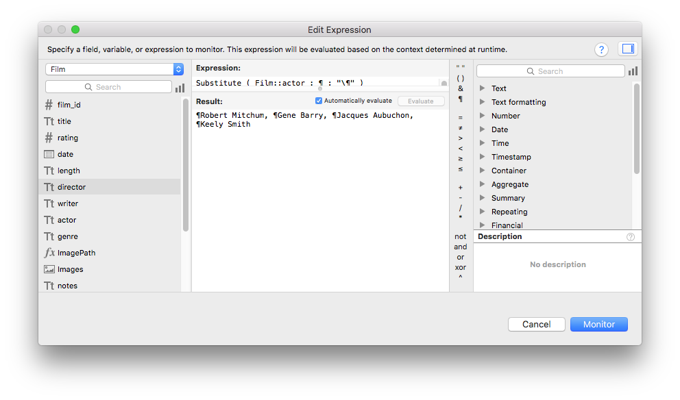

As I suspected, you have carriage returns in both fields. In the actor field, every name is prepended with a return:

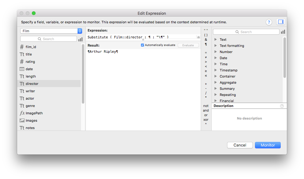

In the director field, there is a carriage return both before and after the name:
If these values are imported, and you want the returns to be removed during the import, set both fields to auto-enter a calculated value =
Substitute ( Self ; ¶ ; "" )
and enable auto-enters in the import dialog.
