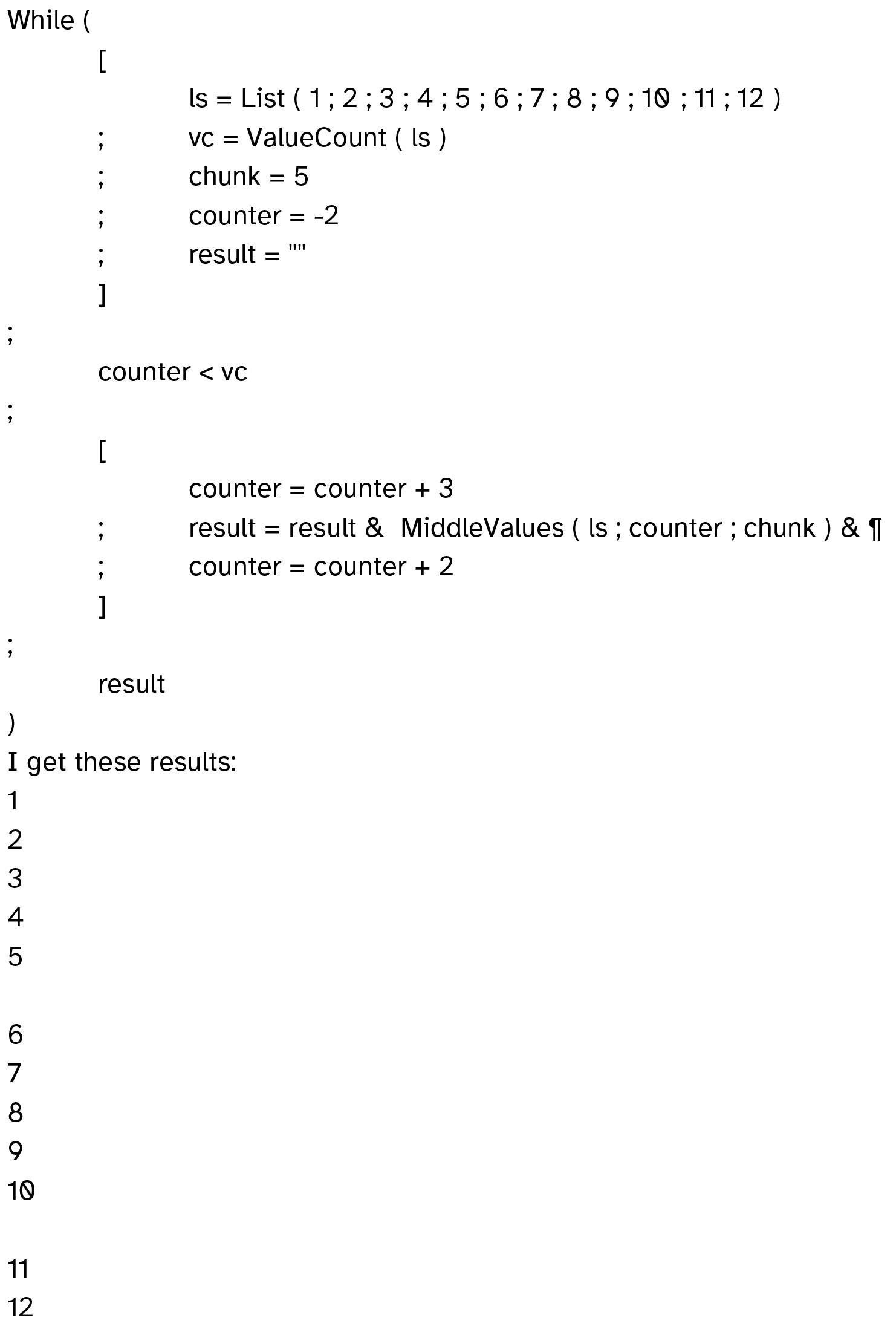

I have a list and I want to separate it into chunks of, let's say, five values each, and then present it in colums.
I think the way goes through the while function in which I'm not very good...
I can make the chunks, and in another while emulate the final result I want to accomplish, but I can't connect the dots...
Any advise?

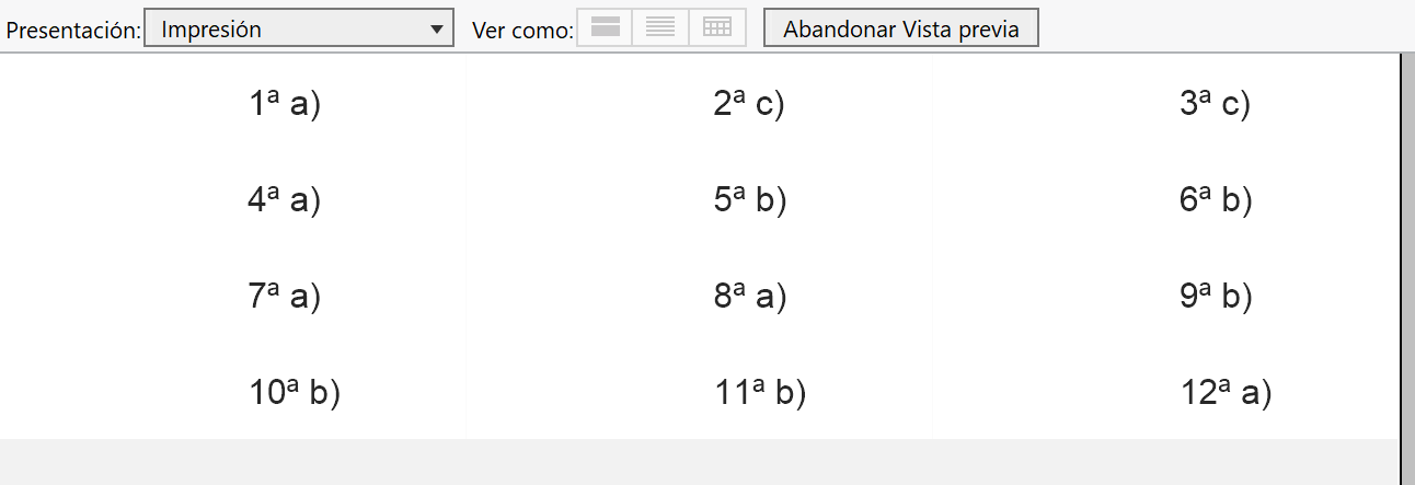

So is that the final result you're looking for, shown at the bottom of the picture*? Does the order (down-first) matter? Or could it be across-first?
Also, wouldn't a portal (or, if you prefer, portals) be a better tool to present this data?
P.S. Please post your code as code, not as picture, so that we can copy it and work on it.

While (
        ls = List ( 1 ; 2 ; 3 ; 4 ; 5 ; 6 ; 7 ; 8 ; 9 ; 10 ; 11 ; 12 )
    ;     vc = ValueCount ( ls )
    ;     chunk = 5
    ;     counter = -2
    ;     result = ""
    counter < vc
        counter = counter + 3
    ;     result = result &  MiddleValues ( ls ; counter ; chunk ) & ¶
    ;     counter = counter + 2
    result

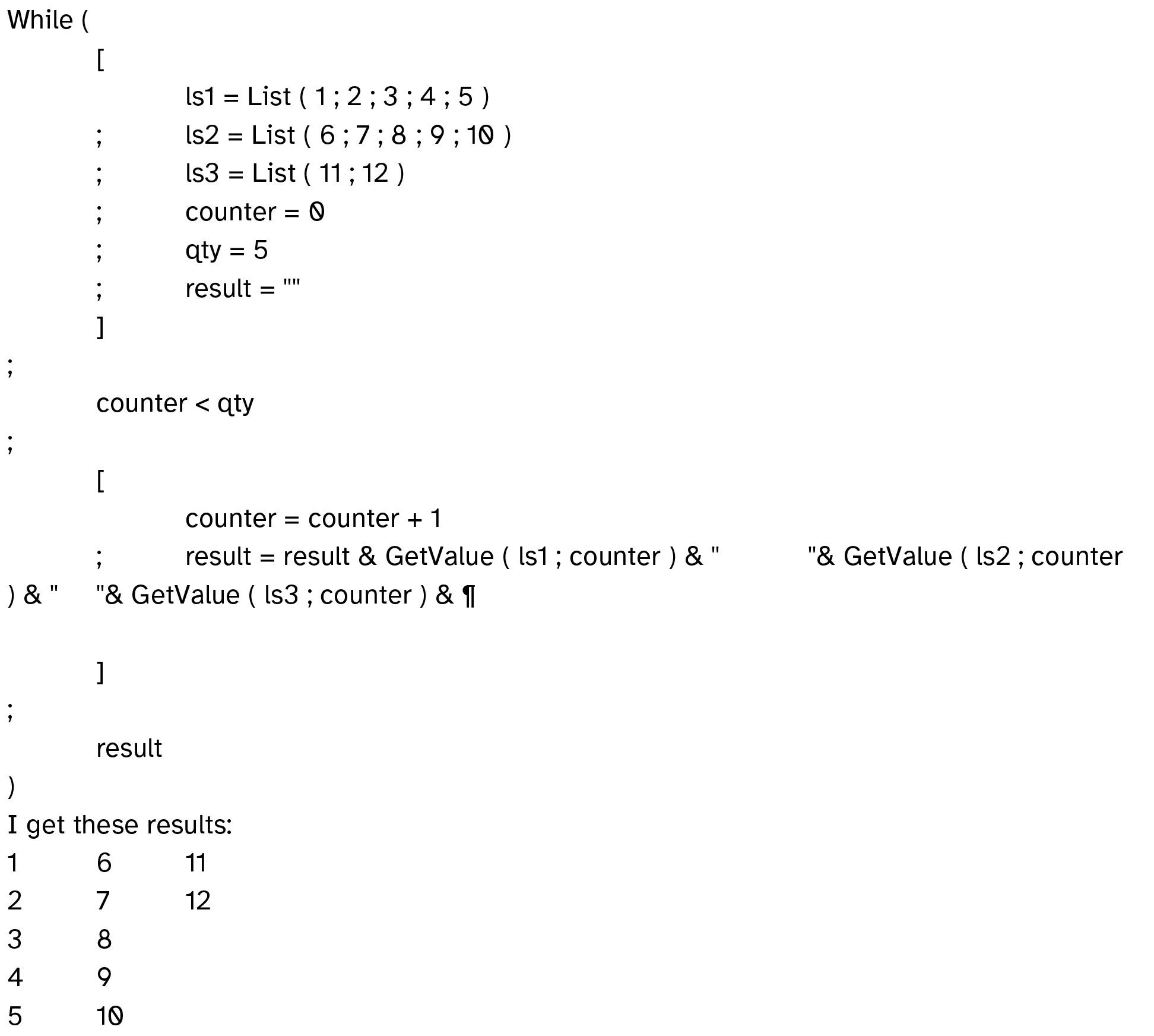

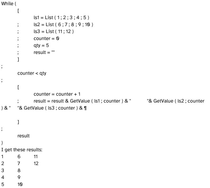

The second while...
While (
        ls1 = List ( 1 ; 2 ; 3 ; 4 ; 5 )
    ;    ls2 = List ( 6 ; 7 ; 8 ; 9 ; 10 )
    ;     ls3 = List ( 11 ; 12 )
    ;     counter = 0
    ;     qty = 5
    ;     result = ""
    counter < qty
        counter = counter + 1
    ;     result = result & GetValue ( ls1 ; counter ) & "    "& GetValue ( ls2 ; counter ) & "    "& GetValue ( ls3 ; counter ) & ¶
    result
I hope this is a better way.
And yes, the final result is the one shown at the bottom of the last picture.
It is the result of test exams. Sometimes are 10 or 20 questions and some others are 100 questions, so I'd like to present it in columns of 5, 10... or so values.

Result to accomplish:
1. a)   6. b)   11. b)
2. c)   7. a)   12. a)
3. c)   8. a)
4. a)   9. b)
5. b)   10. b)
Ten or fifteen values are easy to show, but one hundred not that much (ten columns of ten values is best).

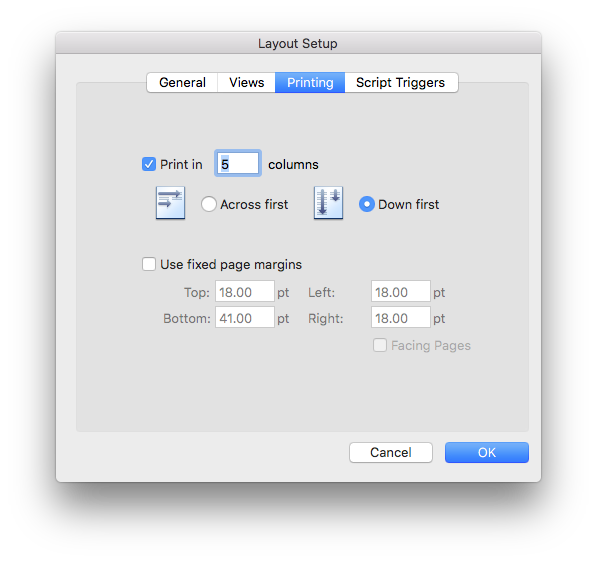

If your values are records, then at least for printing Filemaker provides a built-in solution:
But do note that even with "Down first" selected, you need to specify the number of columns, not the number of rows. Filemaker will add as many rows as required (spilling to additional pages, if necessary). It will not produce columns dynamically. That's a general rule that applies to list views, table views, portals and practically everything (except a web viewer).

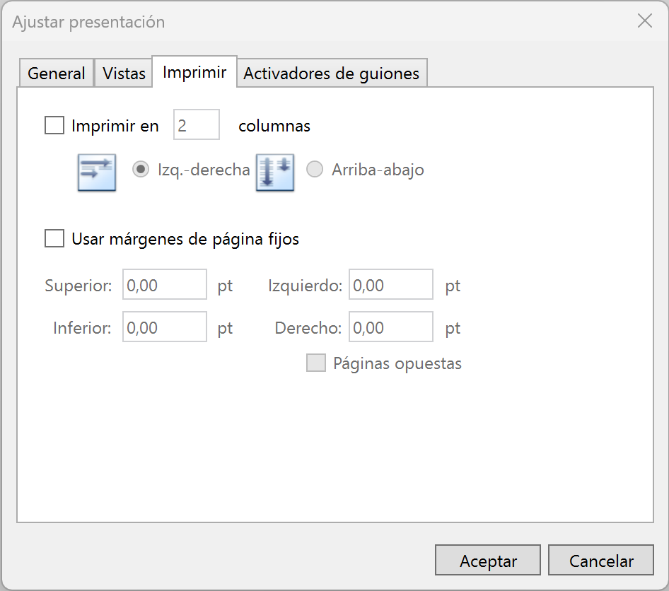

I understand now the mystery about down-first/across-first. As you can see, in spanish is translated as left-right/up-down, that's why I couldn't make the connection.
