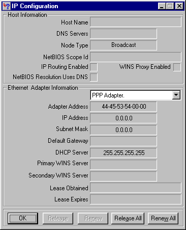

Here's one way to get the IP.
On Win 98se click Start - Run - and type in winipcfg and hit enter.
Under Ethernet Adapter Address is the "IP Address" Field.
If it is all zeros they will need to click the drop down area and choose the modem.
I'll try and attach a screen shot

Maybe 64.63.x.x is the IP assigned by the ISP and
169.254.x.x is assigned to the network card.
Run winipcfg to verify by using the drop down box.
If the above is true then FM is listening on the network instead of the dial up and I'm not exactly sure how to remedy that easily - maybe unplugging the network cable and rebooting might allow FM to listen on the isp connection.
