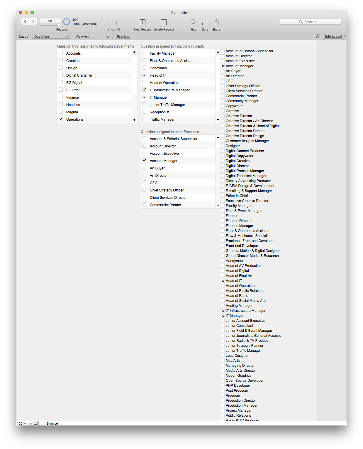

Found this and works perfectly! Thanks for that. The reason why I prefer it over regular checkboxes is that value lists can change and cause problems on layouts when extend when more values are added in the source table, or when they are long in the first place. See attachment, on the right-hand side.
I applied it to a layout with a portal listing Departments. In a second portal, I use the values of checked items as a key to filter out another portal with Functions. I also added a similar portal below that one, listing Functions in UNchecked Departments. Still to do is adding yet another Portal, there will be Employees filtered by checked Functions. So this is a kind of cascading selection tool to limit the list of employees (200+) in the end. (Employees not shown in attachement.)
Now is there a way to sort the Functions (and Employees) portal so checked items float on top of unchecked items? This becomes important – especially in the UNchecked Department Function portal – so it is immediately apparent if other Functions (in UNchecked Departments) have been selected. (Example is the "Account Manager" that is checked and visible, but should be on top...)
Edited by Roeland De Windt
Added screenshot to clarify
Sort by checkbox, descending then the field you want, ascending, and check the box 'Keep records in sorted order
Impossible. As the checkbox field is in the current file, I cannot select it for sorting. Only related files can be selected for sorting, and this is not the case using this technique. I could (and am already) sort by the name field of the Department, Function or Employee, as those are related tables.
It's possible, but not exactly simple. I am not sure it's such a good idea, though. If you have that many options, I would suggest using two portals - one for selected options and one for unselected ones. I have posted a demo of this method

Thanks for replying. The screenshot is a quick'n'dirty layout just showing the checkbox field to see what's going on under the hood. Will take them of the layout when done developing.
Comment,
Thanks. I came to the exact same conclusion and have it working: 1 portal for checked, and 1 for unchecked.
