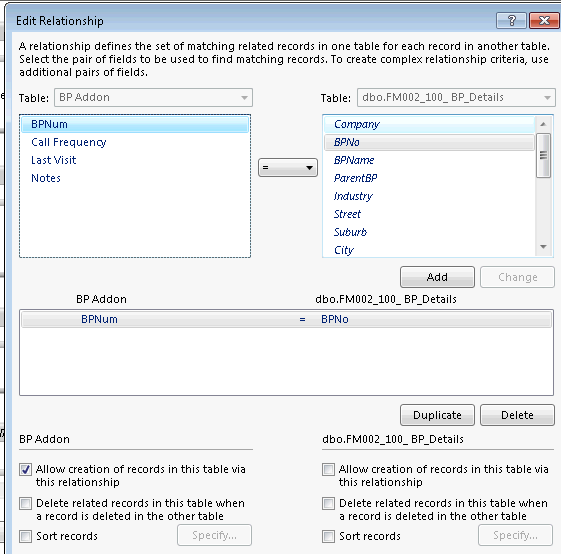

I have a table of customers (BP_Details) which is retrieved from SQL server view using a DSN.
I then have a local Filemaker table ("BPAddon") which I've linked to the BP_Detials table using a unique customer ID field.
I wish to populate the records in the addon table via the Cusomter layout to supplement the data from SQL.
As there are no records in the addon table I've selected "allow creation of records in this table via this relationship" on the add on table side.

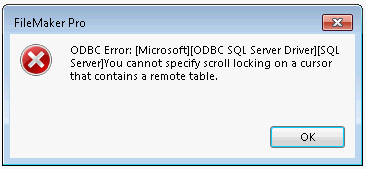

I can browse records fine, however as soon as I add data in a field on the addon table I receive an ODBC error: "You cannot specify scroll locking on a cursor that contains a remote table".
Am I doing something wrong in the relationship?
I don't follow why are doing this, why not work directly on the ESS table?  That's what it is there for...
I'm not sure that ESS respects the auto-creation relationship.

Ok, fair enough.  It's a little uncommon because typically you'd expect the ESS tables to have the fields you want.
Change your workflow to explicitly go to the ESS table and create the customer record when you need it.  Don't rely on the auto-create part of the relationship.

If however I click on a field and change it in the portal, e.g. the position, I receive the same ODBC error. I can avoid this by remove the edit in browser mode, but I thought it would be possible to edit related records on the layout of an ESS table?
