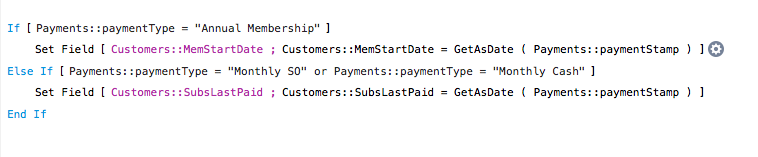

I am trying to set fields in a related customer record based on a choice made in a payments table portal row.
The scenario is that in n the Payments portal row, the user will select a PaymentType from choices governed by a Value List. The Type chosen, will then set either one of two fields in a related Customer record via an attached script trigger - currently onObjectExit.
if paymentType "Annual Membership" is selected, the Customer::Membership StartDate will be set with the date of the payment. But if  paymentType "Monthly" is selected, the Customer::SubsLastPaid field will be set with the date of the payment.
Reference: Script 1.png
Isolating either of the Set Field Script steps in my example (see attached Script 1.png) works fine. But weird things happen if combined into the same Script as they are. For example, If I select  “Annual Payments” for the paymentType, the Customers::memStartDate updates fine, but any entry in the Customers::SubsLastPaid gets erased!

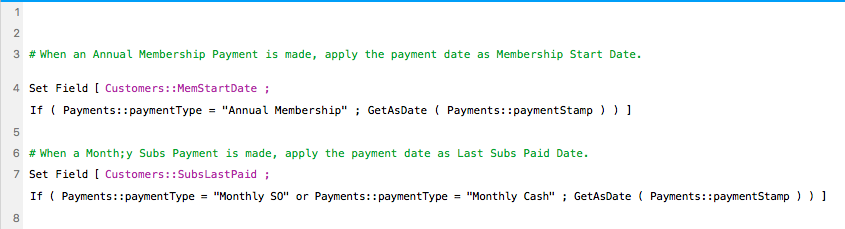

Reference: Script 2.png (The If Else script)
So I thought about it and tried the following (see attached Script 2.png) which makes sense as read, but obviously messes up syntactically because I don’t know the correct format. What happens is that the relevant paymentType gets selected and the associated Customers field just gets populated with a ? (Question Mark)
There is something very wrong with this requirement. If PaymentType is an attribute of payment, it should be a field in Payments - and modifying it should not affect any attribute of customer. It sounds like you are using a script where you should be using an unstored calculation field.
Hi comment, Thanks for the reply,
Yes, paymentType is in the Payments Table. I have a layout for customer check in that shows a summary of subscription details. On this layout is a payment portal to update the following fields for a related record in the Payment Table: paymentTimestamp, paymentAmount, paymentType ( value list).
Maybe I just need to have the Member Start Date and LastSubsPaid fields in the Payments table too, instead of in the Customers Table. I'll try them as unstored calculation fields in Payments.
I'm, only 3 months into my FM adventure and making great progress, but this foxed me. In a couple of months I know I wont have these issues of logic.
Cheers.
By their names, they seem to describe the customer, not any specific payment - so they should be in the Customers table. My point is that they should be calculated dynamically, based on all related Payments - not set ad hoc as a result of modifying a specific payment.
