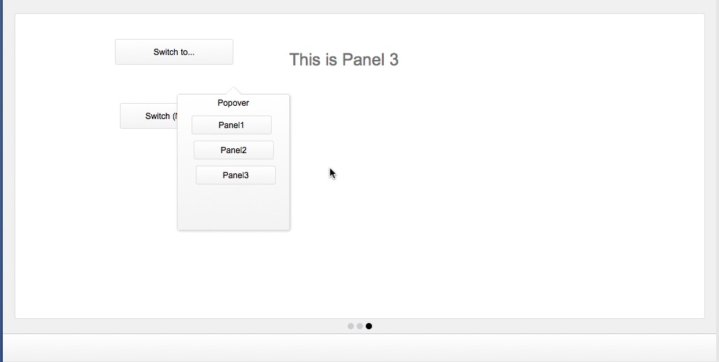

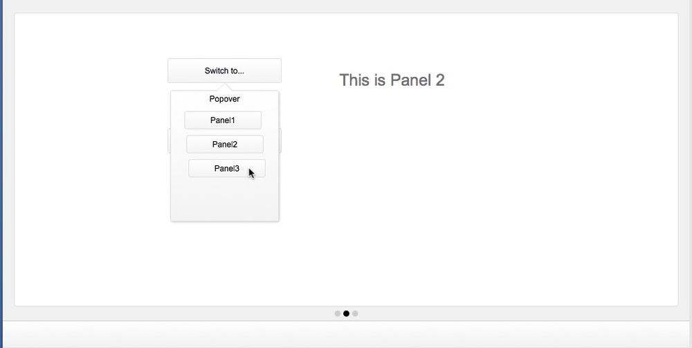

Removing the pause, for me, made it look like nothing is happening (stays on the same panel), but re-inserting it shows the window going to the destination  slide panel for the duration of the pause, then jumping back. This is using the script with the Close Popover step active.
With the removal of the Close Popover step the attached screenshots show what is happening for me. Note that the position of the switch is different on Panel 3, but the popover hasn't moved. (It does go away if I click anywhere on the layout, as expected [but adding a go to object [ ] to the script does nothing].)
