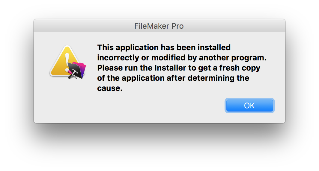

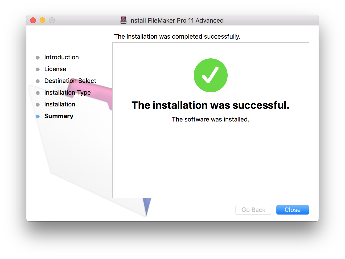

Attempting to install FM11PA on my MB15R fails, well the installer appears to work fine( as pr attached image, ) but launching the app( as pr attached image ) tells me somebody has been fiddling with the installation and that I have to reinstall the application.

The installer will indeed not run correctly on Sierra, this appears to be due to the installation package not being compatible with the new installer application.
One of the symptoms is that the serial number entry part of the installation script is skipped.
Installing on a machine with an older MacOS and then dragging the application over to the machine running Sierra seems to work OK though, just like having Filemaker 11 installed before upgrading to Sierra.

I tried copying a working FM11PA application and ~/Library/FileMaker from Mavericks and receive the same error as above after dragging in the app to Sierra.
