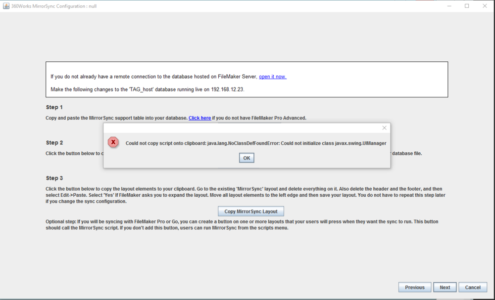

I have purchased the licence to upgrade from MIrrorSync 2 to MirrorSync 3 and have begun to install it. The configuration tool explained that the MirrorSync table and scripts were obselete and I needed to copy in the new ones, however, upon copying the scripts I get the attached error message.
Copying the table and layout works fine, but not the scripts.
It also worries me slightly that the application window title shows as '360Works MirrorSync Configuration: null' - is this a concern?
I have tried re-downloading the configuration client, with no luck as yet.
Any guidance would be greatly appreciated
Lewis
Hello again,
I have fixed this issue by uninstalling MirrorSync and re-installing v3
Sorry for all the fuss :)
