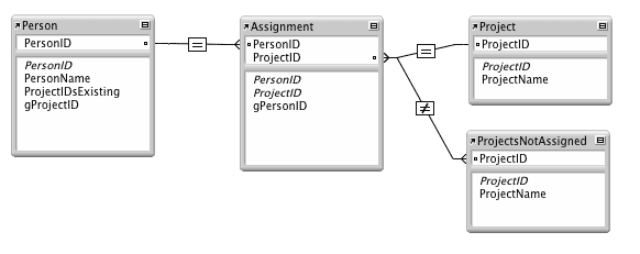

This idea of an exclusive value list sounds like it could be useful, and it seems like there should be a cool way to do this dynamically with FM7's new conditional relationships. To try this, I went with a more intuitive example: Assigning projects to people, where you would only want to show the projects that that person has not already been assigned. I came up with a good design (shown below,) but I wasn't able to get it to work. There are two problems I ran into:
1. If there are no records in the Assignment join table, then the relationship has no matches and the conditional value list won't work.
2. There seems to be a bug with the <> relational operator when trying to use it from more than one table away. It works when there is one portal row, but not more than one.
The value list is based on the Person table, showing only related ProjectsNotAssigned.
Instead what I came up with uses scripts to add and remove assigned projects. The scripts also set some IDs so that there can be a direct relationship between Person and ProjectsNotAssigned, avoiding the problems I noted above.
The attached file demonstrates this technique. It works fine, but man, I wish I could get the dynamic method to work. Maybe someone else has succeeded?
