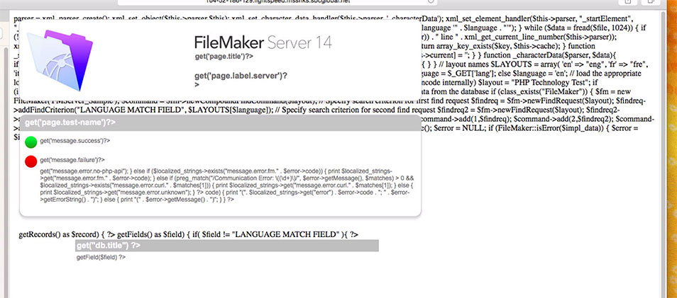

Ah, I forgot about the test page, actually.  Sure enough, something seems completely messed up.  I've attached a screenshot of what I get when I run the test on this server.  Any idea why that would be happening or how to resolve it?
In the status area it shows green check marks for everything like all is well, but obviously that's not the case.
Sorry, I'm not sure. I haven't seen that before.
If I had to guess I'd say that the web server/php is miss-configured. You might be able to fix it by re-deploying (I believe that option is available in the top-right of the admin console).

Yes, after I got that scrambled test page I removed and re-installed FM Server, went through fresh deployment, and then the test page worked nicely.  So then my other stuff started working, too.
