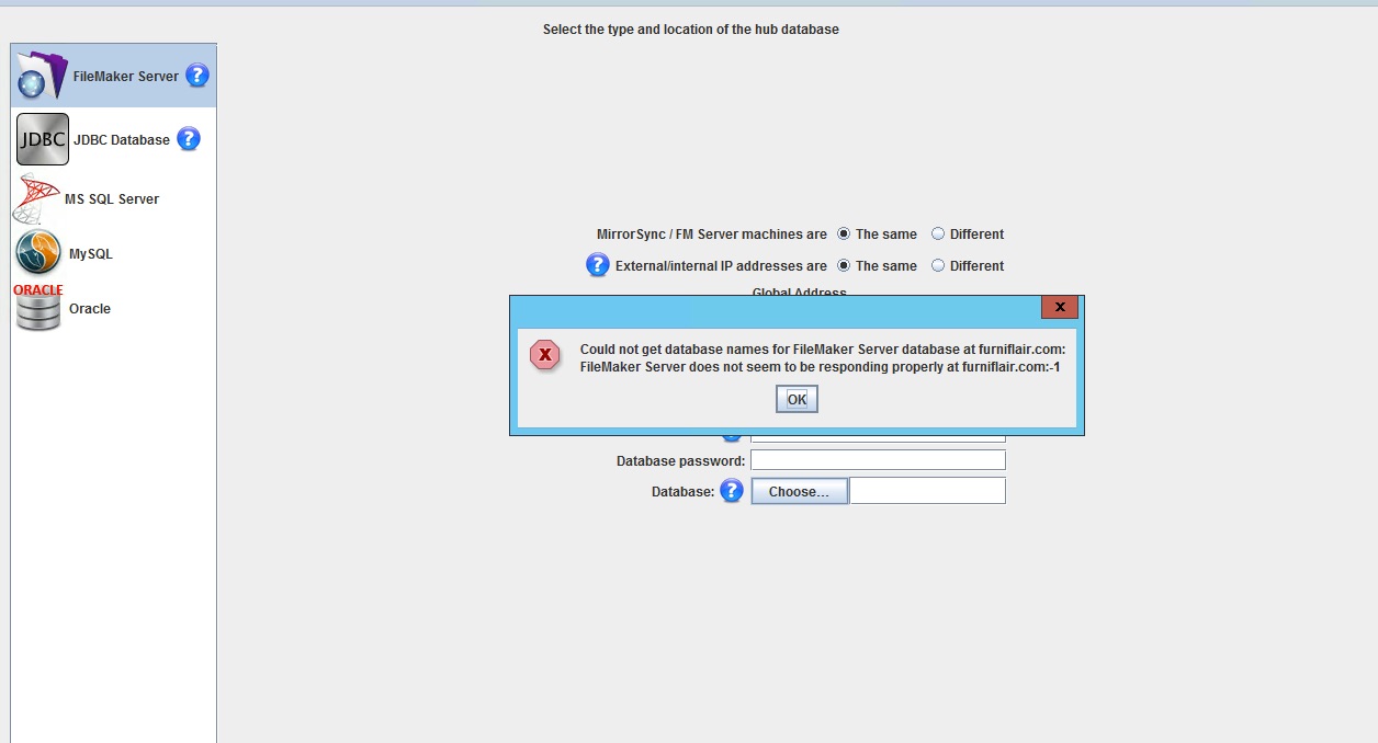

I installed today mirror sync as a trial on a filemaker server to give it a try. After Installation and reboot of the server (basically it wasn't responding) I logged in on mirror sync and start creating a new configuration, but It gives me an error when I try to access to the database server.
What am I missing?
This error indicates an issue trying to read data from the FileMaker database. This could be because your XML publishing engine is off or broken, among other possibilities.
To debug, you can run this query in your web browser on the server you installed MirrorSync and see if you  get an XML response.
http://localhost/fmi/xml/FMPXMLRESULT.xml?-dbnames
In either case, you can go to localhost/MirrorSync and submit a problem report and we can take over in our ticketing system to get you sorted out.
