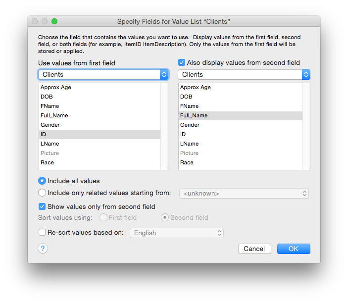

Your "Clients" value list is not set up correctly.
See attached for corrected setup.
Note that the same problem also exists in your other file.

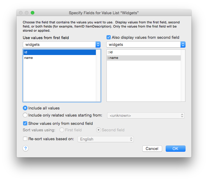

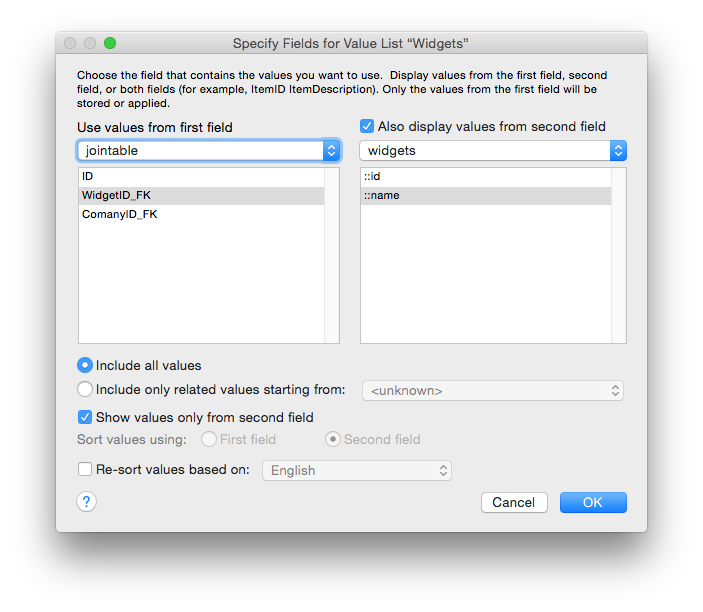

As noted. Original and corrected value lists for Test.fmp12
