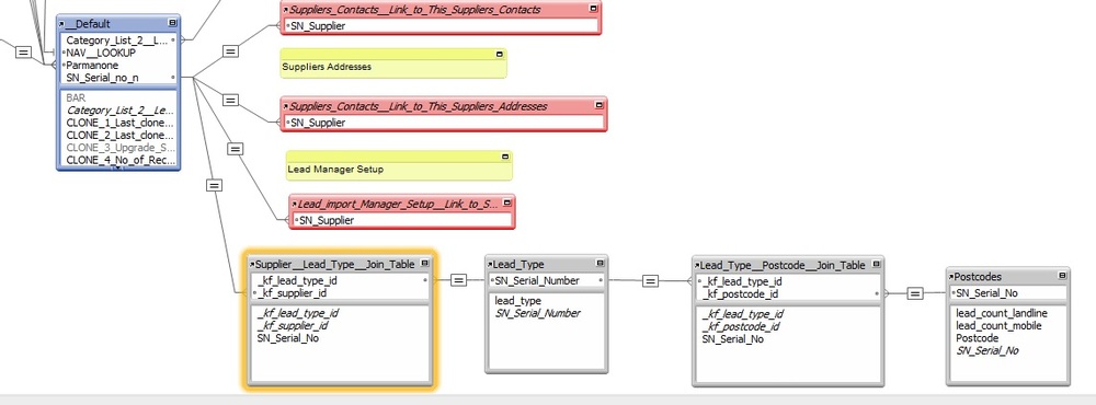

I am trying to setup a database to record some info on postcodes. What I need to do is, each supplier can have 4 types of lead (back data, profile, survey, 2nd use). I have two tables for suppliers and postcodes already. I also have 2 join tables for many to many relationships. I need each field in the postcodes database to be able to store a count for each supplier's lead type.

My problem is with the way I have set the relationships up currently. When I add a count for a postcode it adds that count for all suppliers. I need the postcode count to be specific to each supplier and lead type.
Can anyone tell me what I need to do to get this working correctly? I have attached a screenshot of my relationships.

This sounds more like a report than a database to me.  That would mean that you don't need new fields in the Postcode table.
What is not clear to me in your structure: in what table/TO do you store the actual lead?  I'm assuming that the 'lead' table stores what supplier, what type and what postcode it is?

The database I am working on uses a new external file for each table. The leads table is actually in a different file and isn't referenced from here (the suppliers database) the count for each postcode isn't based on leads currently in the database, it is actually the count that the supplier is able to provide but we haven't yet purchased. In my screenshot the __Default table is actually the supplier database table.
I don't quite follow I must admit.  If you need to report on the leads table but it is not referenced in the file you sent us the screenshot from then how are you planning on getting to that leads data?
The closest I see this coming together is in that bottom row of TOs.
But the "supplier lead type join" table would need an fk for the post code on each record and that then would become the source TO for your report.
The "lead type postcode join" would go away.

Importing that is straightforward, just add the supplier id to that and you're done.  But I don't see where the lead type comes into play with that data then...
This list was just an example of one "type" there can be 4 "types" but they all have the same sort of data just the source is different so I need to be able to distinguish between the 4 types of lead count (back data, profile, survey & 2nd use) there are around 30 suppliers in the table and 150 postcodes. I need all 30 suppliers to be able to track 4 different lead type counts.
I still don't understand the issue.  If you import that data, and at the moment of import you add the supplier ID and the lead type ID for the imported set then in effect you have a good table of of lead #s per supplier per postcode.  Once you have that, is that enough or do you need to do something with the data.
