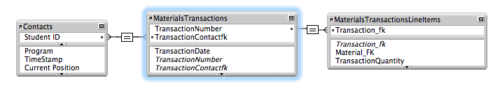

Below are three tables: Contacts, MaterialsTransactions, and MaterialsTransactionLineItems
59ebce73cb3bd_ScreenShot2017-10-21at3_43_32PM.png.d6f1cd90f771973d0a7d9dc5a5ca6715.png
Within a layout showing records from the Contacts table, I created a portal showing records from MaterialsTransactionLineitems (so contacts could see each item and not just each transaction)

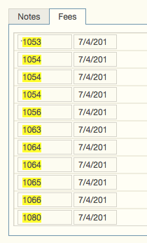

59ebcef11b3c8_ScreenShot2017-10-21at3_44_16PM.png.888c0990b1cd3ef9be51f813a6421b3d.png Layout = Contacts Table; Portal = MaterialsTransactionLineItems
The field on the left is MaterialsTransactionLineItems::Transaction_fk; the field on the right is MaterialsTransactions::TransactionDate
Given the relationship, why is the date not showing correctly? Instead, just showing first record for all? Is it the relationship, or the way I have created the portal... both?

I don't quite understand what your tables do, but if you line items table is an atypical line items table, it should be a join table between Transactions and a Material table.
Also the contacts table seems to be connected to the wrong foreign key.  I only say that because it's showing a many to many relationship.

yes, I didn't show an additional table, Materials, that is a join table. Not sure what is wrong with the foreign key. The Student ID field is a number connected to Contact_fk, a number, in the MaterialsTransactions table...
Is the Student ID field set up as an auto-enter serial number?  Are both key either set as text or numbers.
No auto enter, and both are numbers.

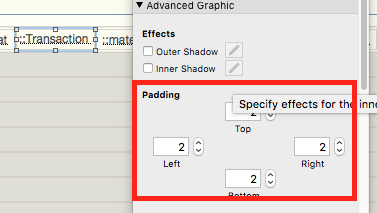

1. Try skinnier padding.

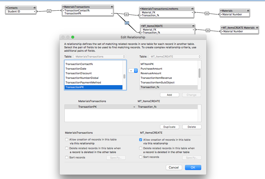

3. Change the graph to add a CREATE relation

Reason for CREATE relationship:
The existing relationship leave a non-functioning ghost bottom row in the portal.
