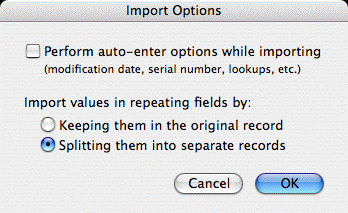

When importing data into the new file you have the option to split repeating fields into separate records.

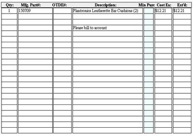

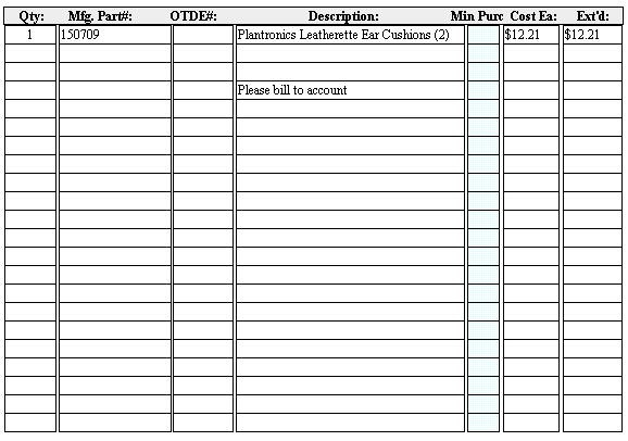

ok, back to the question again that I posted a couple months ago, as we are finally getting around to do the switch, I tried the import method that was listed above and have no clue how to do that. I am going to try the loop but I think that it causes a problem with the point that every now and then there is random typing in one of the fields that the count might not be on. I have included a picture of the database. Any help would be appreciated.
Importing and splitting repeats is extremely easy. Just do your field matching and proceed to the next step, when you will see this:
