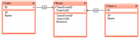

Towns are in one table so this is a many to many self-relationship. This looks like 2 tables are all that are required. The table Towns and the join table.
A many to many self join would work if you only need to know that they are linked. But if you need to know the mileage between them, or other information about the route, then a Town table and a Route or Link table is necessary.
I've been working on a database for exactly this type of relationship. Below is a TOG of how I have mine linked.
The only difficulty with this, is that the joins are one way. To make a link in the opposite direction requires a little scripting.
Yes, that is what I had in mind. If you script the creation of the record in the join table you could create a second record for the reverse direction. A to B and B to A.
