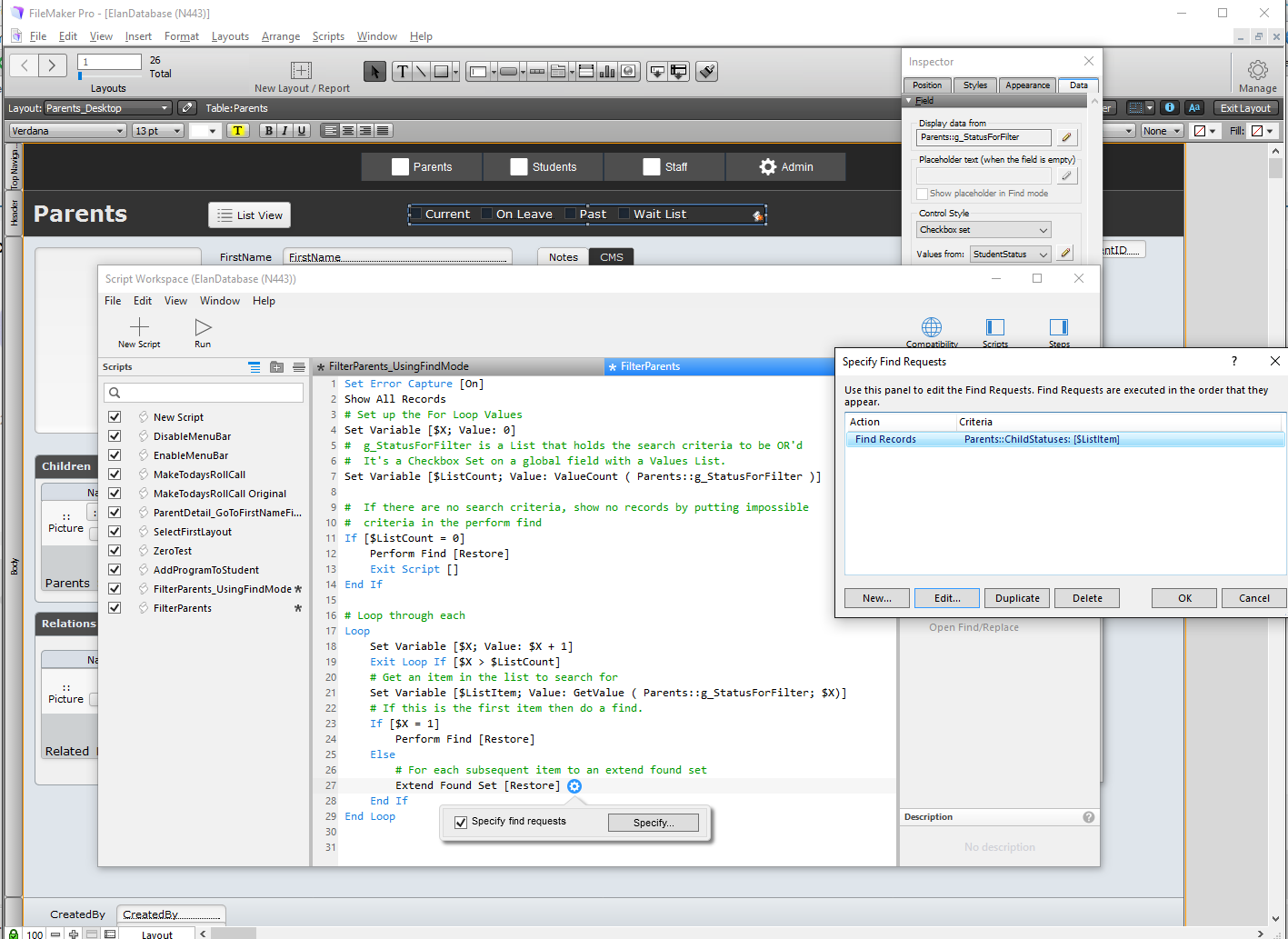

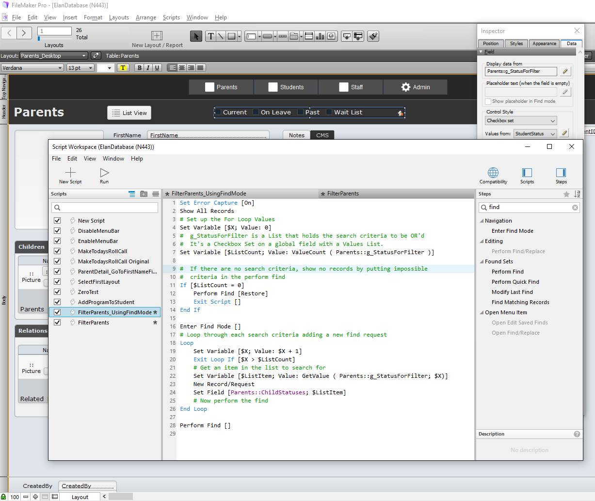

I tried both of your other suggestions and I think I like your first idea better. The search criteria aren't hiding behind some dialog so the script is more understandable. And now I know what the Request part means in the New Record/Request command.
I have attached screenshots of both solutions showing all of the moving parts for others to follow.
Notes:
1. Both the Perform Find and Extend Found Set commands use the same Find request.
2. You can simplify this script if you aren't using lists to match lists and you have a much more direct way to filter your layouts than the relationship way which the FileMaker tutorials seems to prefer.
