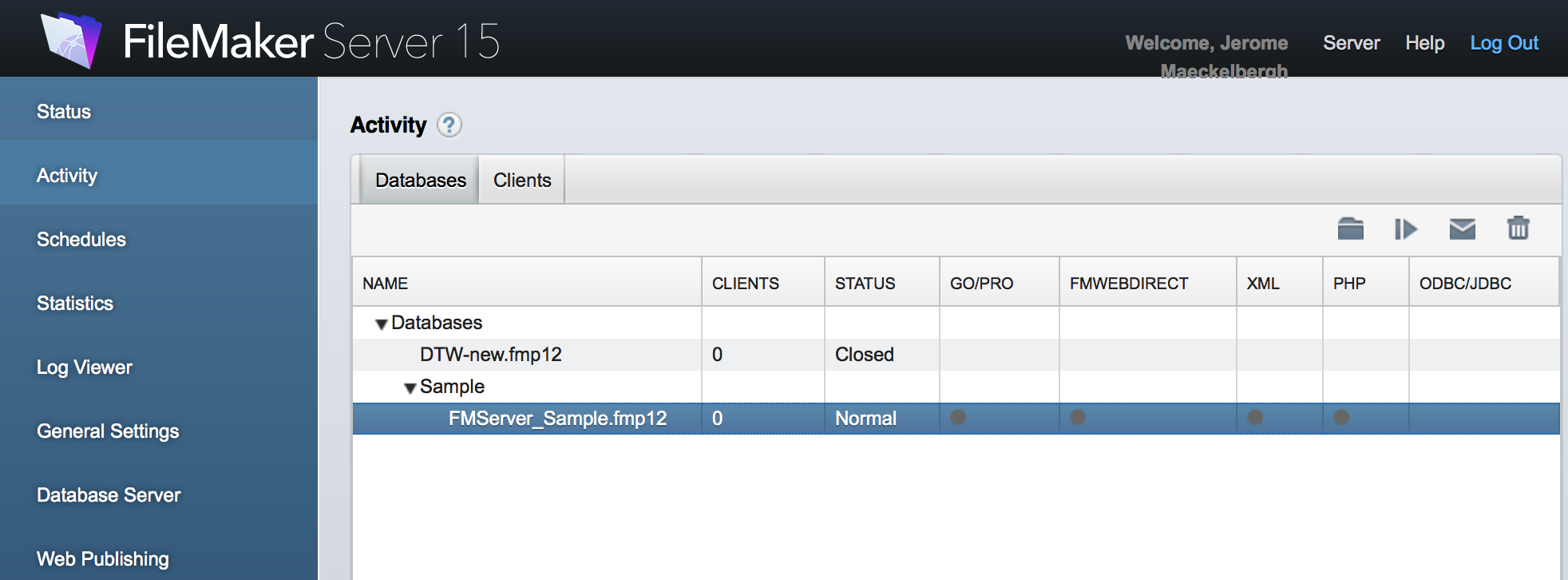

I am working already a few months on my file "DTW-new.fmp12" via the FM-server 15 on my MacBook Pro without problem and suddenly today this file can't be found anymore, although it is still on the server. But it shows that the status is "Closed", so I probably should change this to "Normal" or something else. Sorry for my ignorance, but I can't figure out how to do this. I tried with "open" and "open all", but this doesn't help me.58cabf5727be3_ScreenShot2017-03-16at16_36_27.thumb.png.e6b98275ccbb30e364e3f419234fef57.png

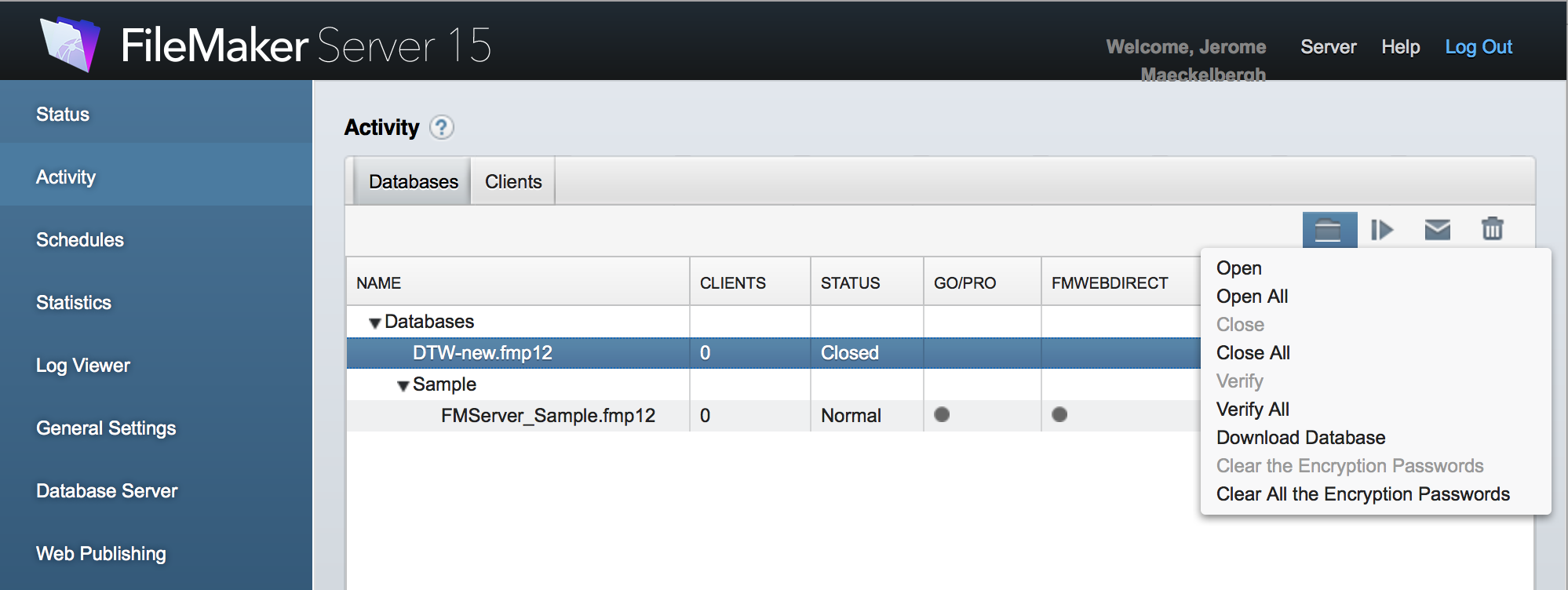

"Open" is what you're looking for, which for some reason doesn't work for you, obviously. What does the log say ? ("Log Viewer" in the left pane)

You can "Download Database" from the same menu (in your first screenshot), then delete the db from server (trash icon on the top-right)
Open the file locally with Filemaker Pro, set a password, then upload it again to FMS using "Share / Upload to server" in filemaker pro.

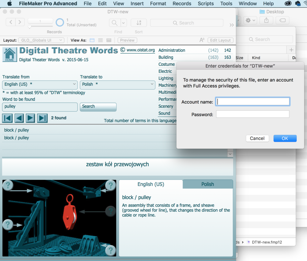

Thanks for your suggestion already. I copied the file to my desktop, but now it seems, although I have full access to all developer's features, I can't add a password to the file. I receive the message "To manage the security of this file, enter an account with Full Access privileges." Whatever I enter in "Account name" and "Password" fields, I can't, what is logical, as I never set this file like that. My guess is that I have to make a new file, this time password protected, and then importing one for one the necessary tables with their fields, layouts, scripts, relationships, etc. and then the content, or do you have any idea that is less labour consuming?

For the moment, your [fullaccess] account has no password, so you may access security by just entering your account name and leaving the password blank.
Then you'll set a password, and when you validate the settings, it will prompt you with the same dialog again, which you will then fill with your brand new password.

Probably it is your third option, as I am working with a FileMaker Server license from a FileMaker Developer Subscription on my MacBook Pro on which I am the only person accessing it. When it is due to a damage of the file, it is a very specific damage, as apart from changing the security access to the copied file on my desktop, I can manage anything else that I need: Database, Scripts, Layouts, etcetera so full access with the exception of Security.
Also my thanks to Lem Alpha, but still whatever I enter as account name (even the classic "admin"), leaving the password blank, I get the same result: "The account name and password you entered does not match those for any FileMaker account.". Normally, as I even didn't specified any account to the file, I should leave both fields blanc but also this doesn't work.

Do you have access to an older version of filemaker pro ? If you have access to a v13, you can access "manage security" without the first dialog.
Dear Lem Alpha, Wim Decorte and BruceR,
Thank you all for saving me much time, in particular to Lem Alpha. I tried first with my still installed FM v14 without result, but indeed with reinstalling my FM v13 I could do the trick. Checked it out with my FM v15 and it works.
