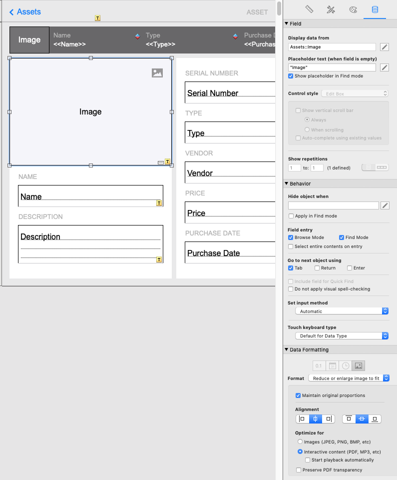

I am using Filemaker Pro 17.  I have created a container field with 'interactive content (PDF, MP3, etc.)' checked in the Data tab in the Inspector. PDF's won't upload.    I've uninstalled and reinstalled Adobe Reader DC.  I've tried other PDF files and they just won't load.  What am I doing wrong?  (I've done is successfully in the past with Filemaker 15 with the exact same PDF files).  I'm using a MacBook Pro with MacOS Mojave Version 10.14.2 (18C54).

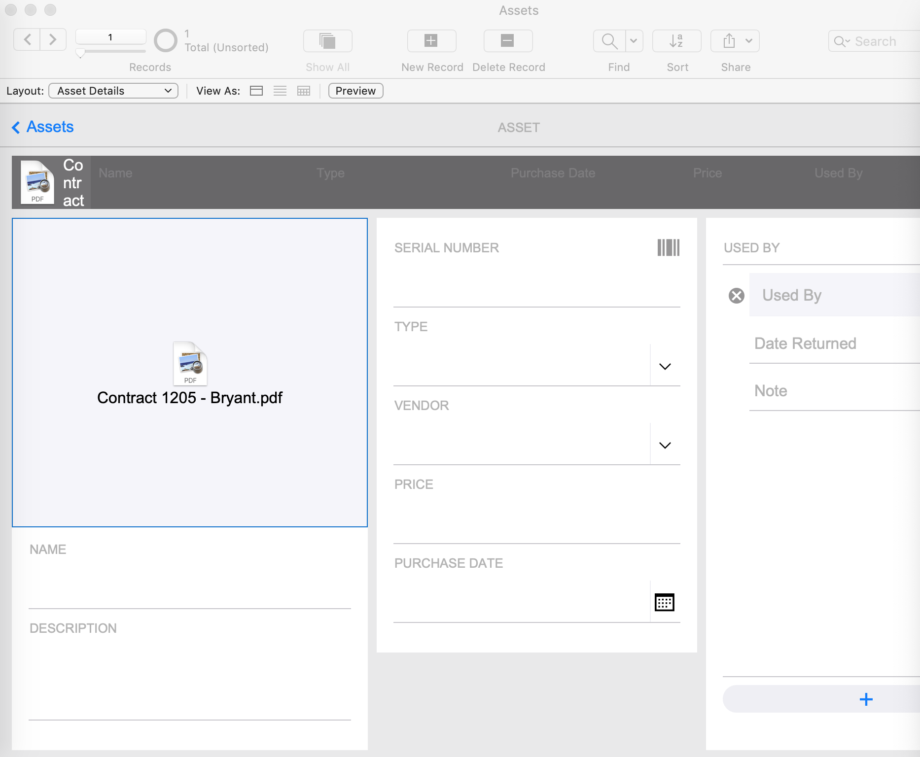

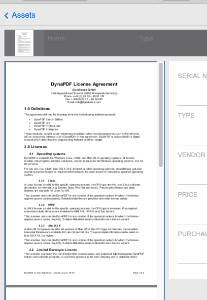

When I right click the 'insert PDF' is greyed out.  'Insert Photo' and 'Insert File' are black and usable.  I did find the PDF file and inserted it but all I get is an icon and the name.
Did you change the settings of the container to interactive?
btw, I do not have adobe installed on my Mac.

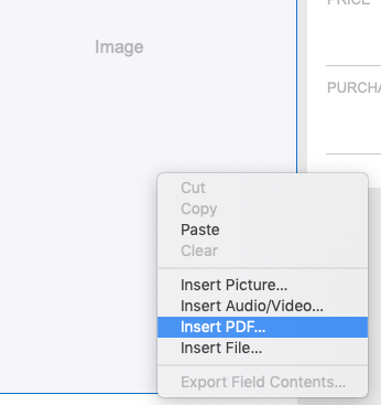

bcooney - I had not changed the setting to interactive but I just did that and, while I can now choose 'Insert PDF' I can not see it.  When I right click on the container field I now get the option to 'Reload' and nothing else.  But the container field is blank.

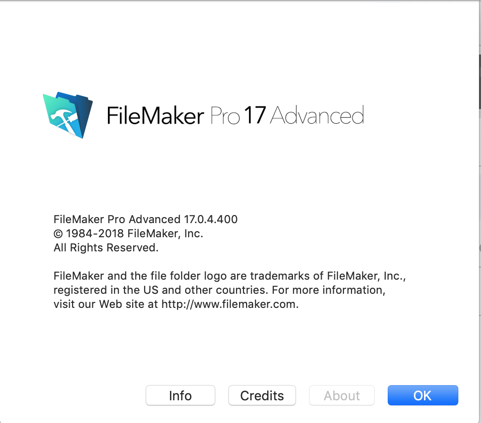

comment - my apologies.  I updated to 17.0.4.400 as soon as I got the notification to do so.  I've been considering uninstalling and reinstalling.
Comment - my apologies.  I updated to 17.0.4.400 as soon as I got the notification to do so (within the last week).  I've been considering uninstalling and reinstalling.

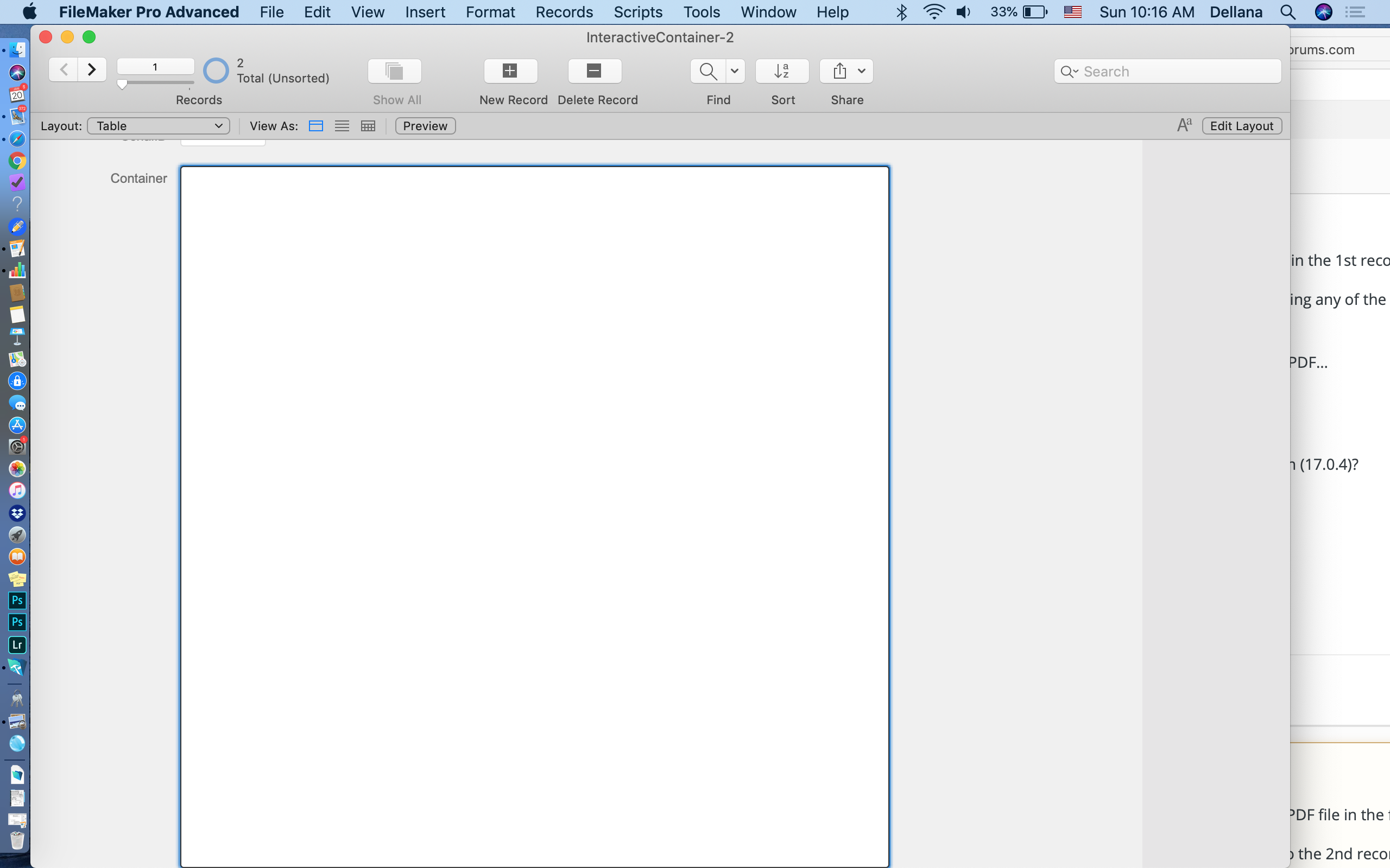

In your file that you sent me, I see nothing.  No file name, no photo, nothing.  In either record 1 or in Record 2 (after I try and insert a PDF which is what I did before taking this screen shot).  Nothing.

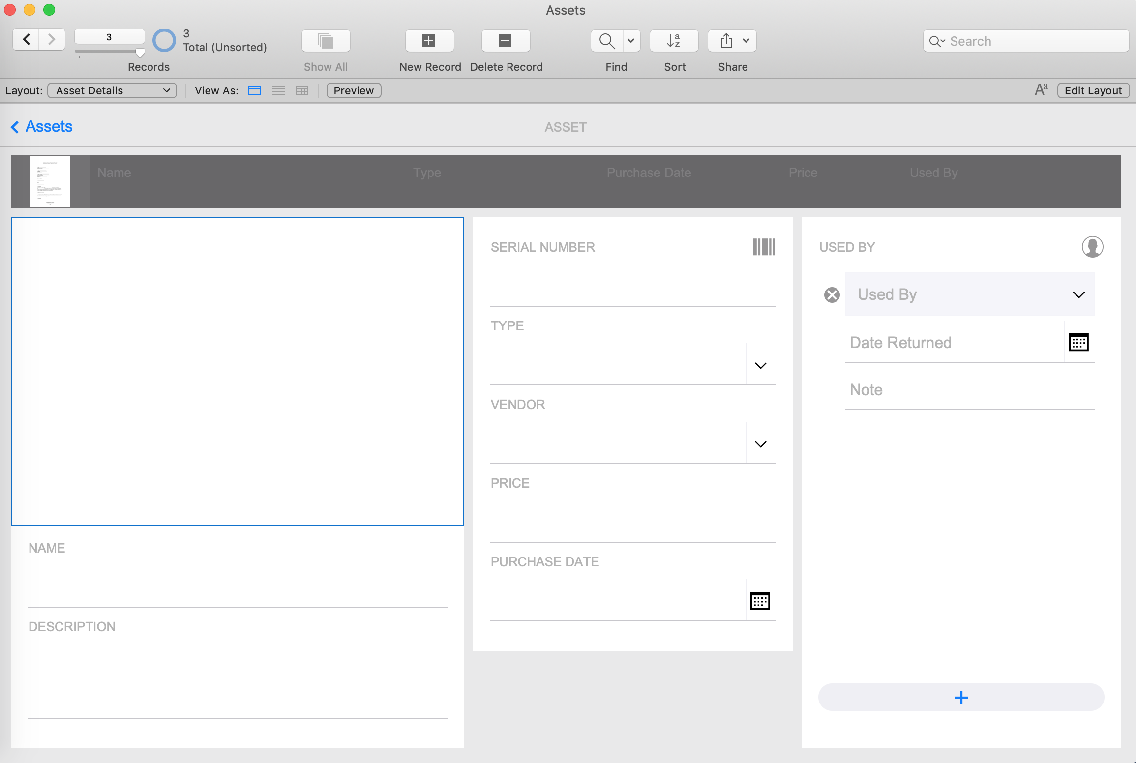

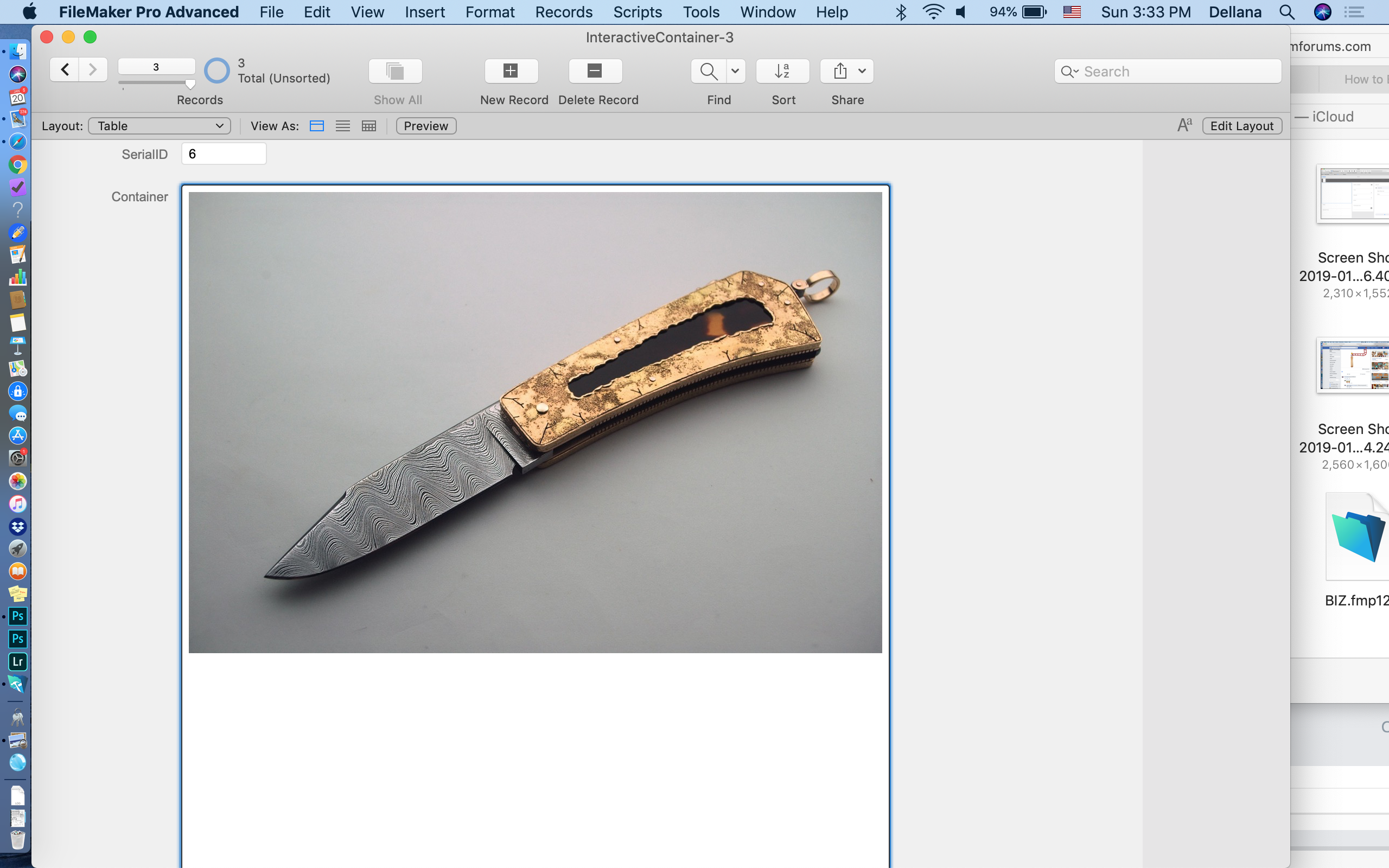

 and restarted my MacBook Pro.  Still the same - can't see the PDF in the container field.  I just created this 3rd record.
I get that little image of the PDF on the header but none in the container field.
I believe those two fields are one and the same field. If you changed the large one to be interactive, that should be the only difference between them (apart from the reduce/enlarge format). So it would seem that you are able to insert a PDF into an interactive field, but you're unable to interact with it.

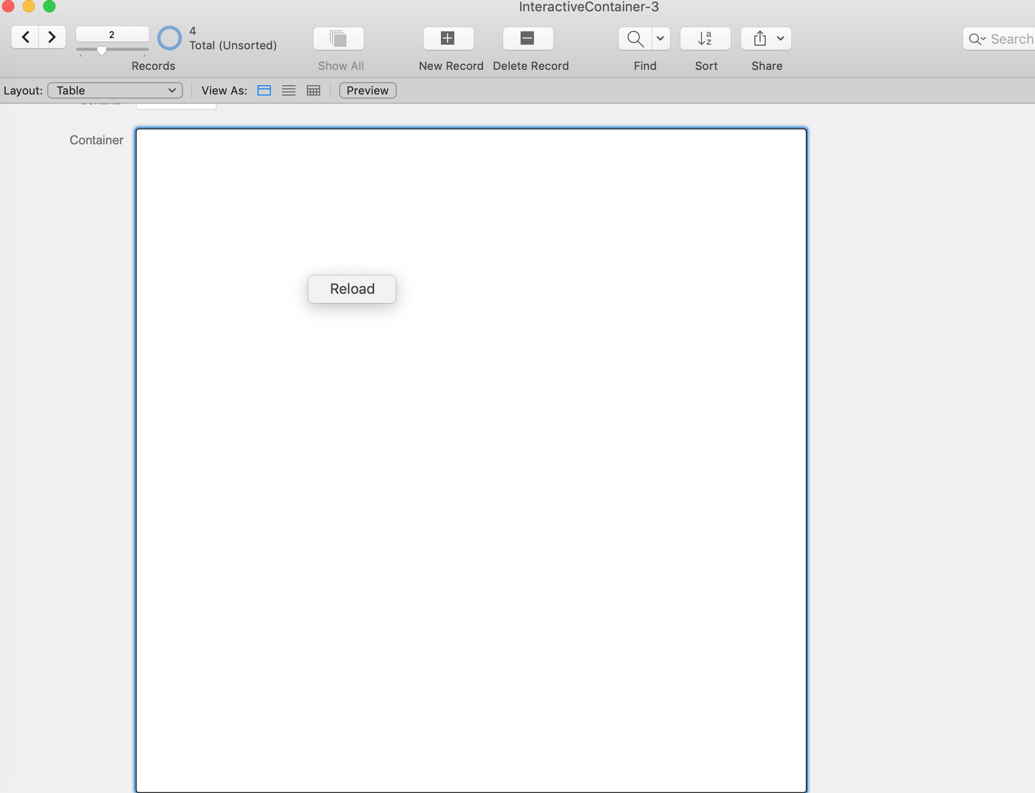

Comment - Yes, that seems to be what is going on.  It acts like it has done something because after I try to insert a PDF when I double click to try again because I can't see it the only option I get (with no other greyed out options or anything else) is 'Reload'.  So it seems to think that something is in there but it is not visible.

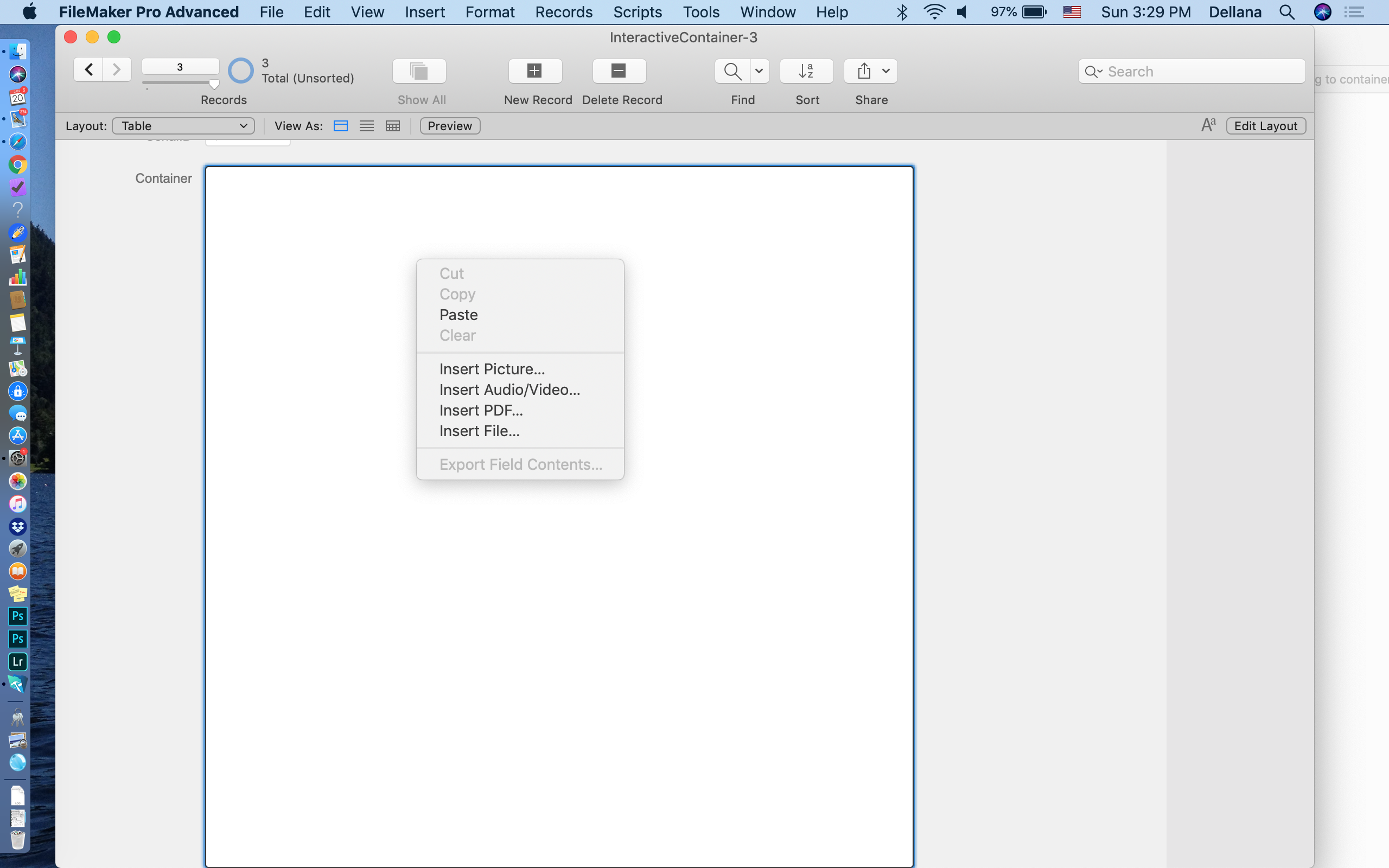

10 minutes ago, comment said:
When you say you cannot insert a PDF in Record 2 - what exactly does that mean? Is the menu option greyed out, or is it enabled and you just don't see a result of the action?
No, them menu option is not greyed out - it's black like the other options.  I go find the file, double click it (or click 'insert) and nothing shows up in the container field.  When I right click to try it again I just get the 'Reload' option like the screenshot above.
When trying to insert the PDF this is what I see:
I can insert an image, though.

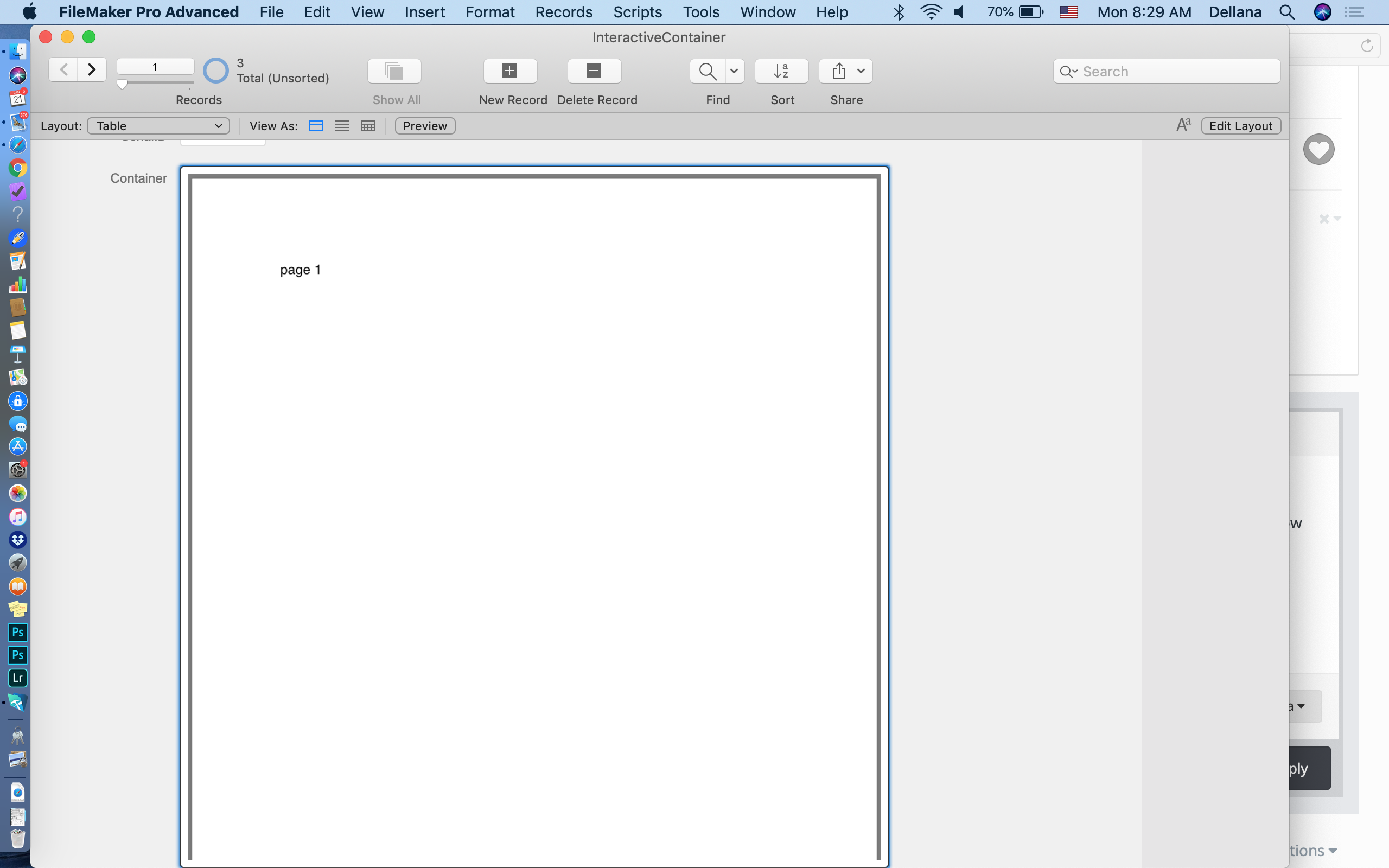

I've uninstalled, restarted my MacBook, redownloaded and re-installed Filemaker 17 and it now works!
bcooney - I can add PDF's to the container fields in the Asset database.
comment - I can now add PDF's to your file.  In your Record 1 I can see Page 1 and Page 2 (see screenshot).
