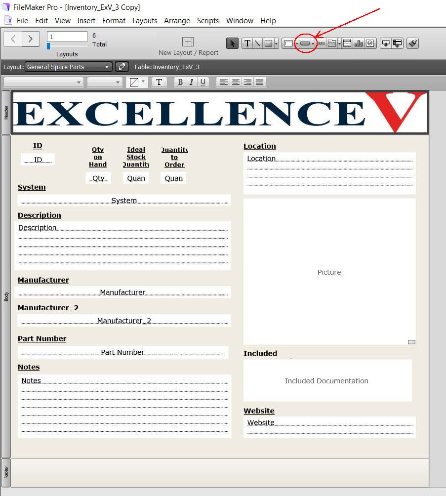

I created the buttons using the button icon on the toolbar shown below.

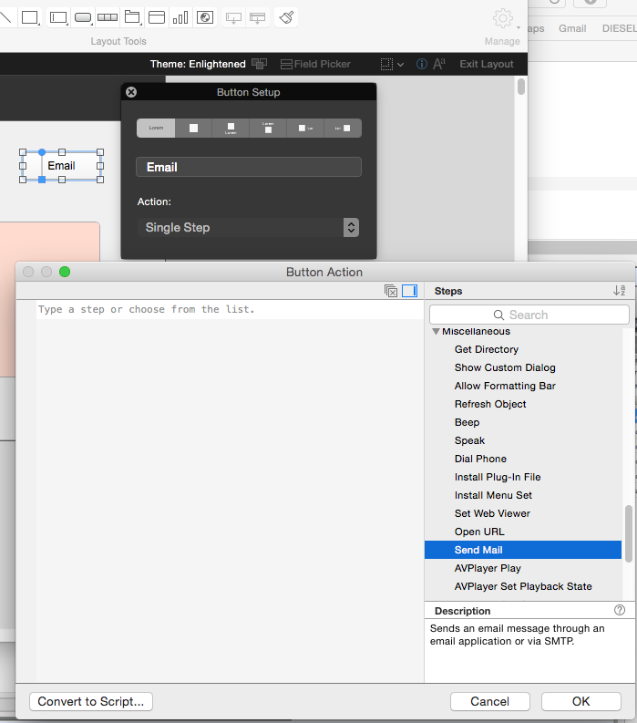

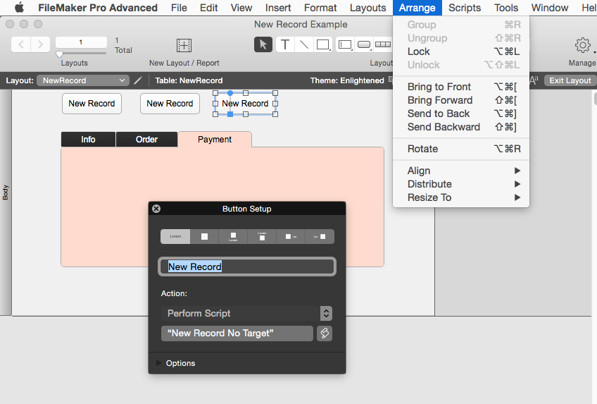

Attached is a screenshot showing options for a button, set up in 14, and designed using the button tool.
Something is missing in your description.
I think it would be better to have a copy of the file or a mockup showing the problem.

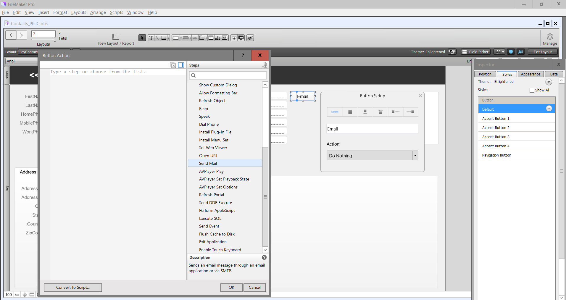

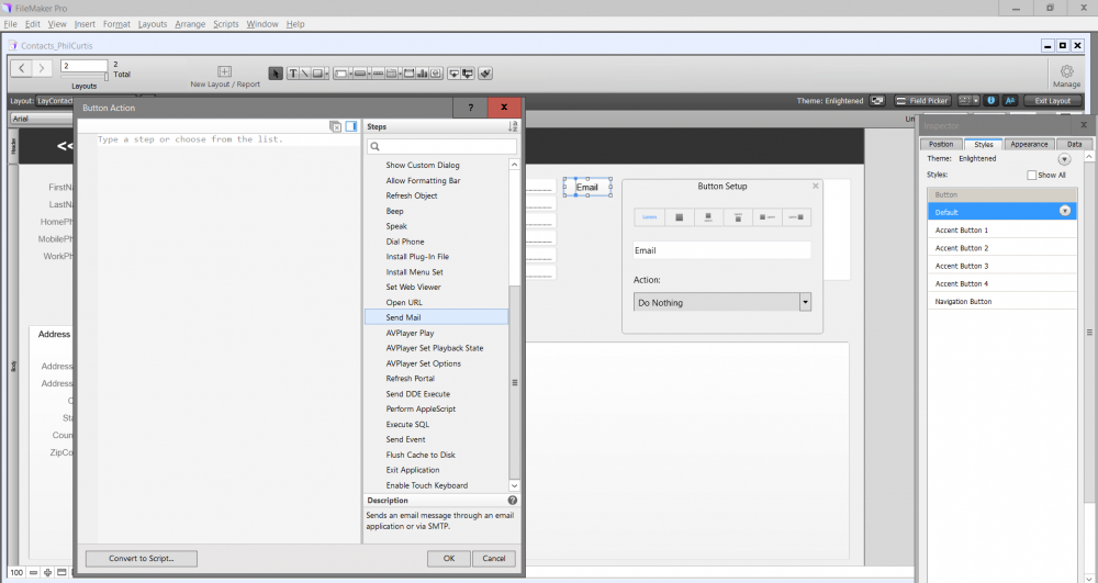

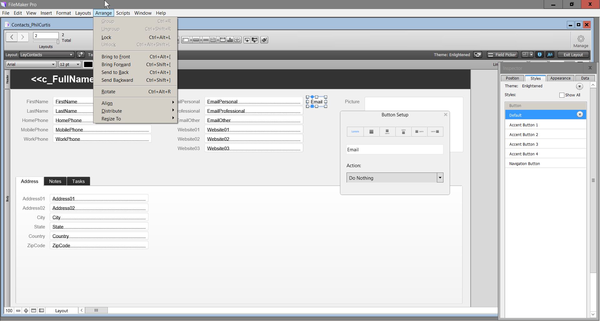

I am finally back at my PC and here is the screenshot.
01.thumb.jpg.b0a0a8be582eea09a9708647871
The Theme is 'Enlightened', the default.
I have not created, or done anything with Styles.
I am very new at FM, about a month.
I still can not set the button to anything, it just keeps going back to 'Do Nothing'

Your screen shot isn’t providing much help, because we can’t actually see if you have attached a script. Hold on, I just notice the Button Setup window it shows that it is set to “Do Nothing"
The Arrange Menu is for working with layout objects, not scripts?

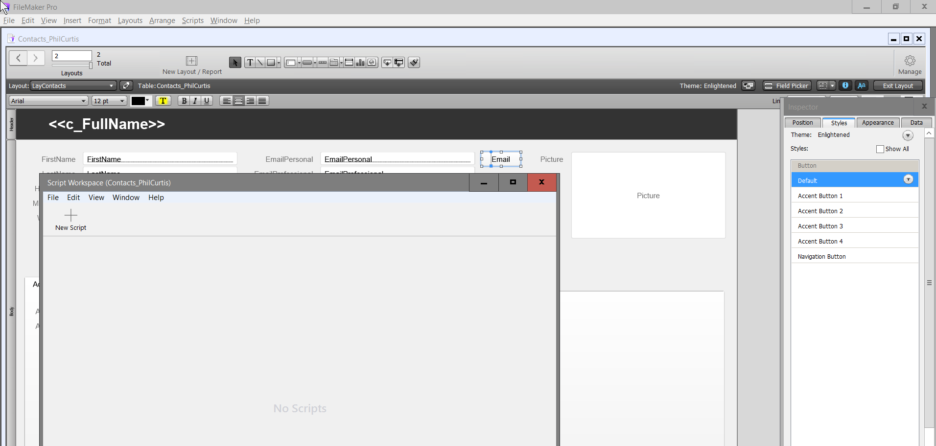

What shows under Scripts (next to the Arrange)? Script.png.bb5d7a7307b8a0c0eff9e1a17403a
It appears that you have an orphan button (i.e. no action assigned to it).
01.thumb.png.a545cb97466b6ed868d464fbf8d02.thumb.png.1130917bae88a58131ff3c7fa88

I see everything, but a script for the button “Email”.
I was not trying to do a script, only a 'Single Step', 'Miscellaneous', 'Send Email'.

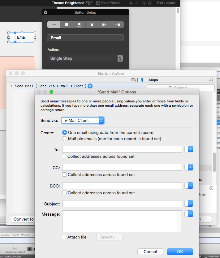

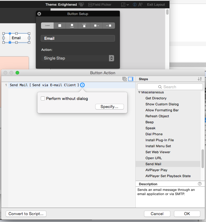

Actually, in FileMaker 14, you have the option to set a button to use a single script step, such as send Email; and then if you want, convert it into a script. Looks like Philip is almost there, and actually just needs to double click the step he has selected in the first image of his message from 2 hours ago. This would cause the script step to appear in the "type a step..." region.
But that said - I think is usually far better to actually go ahead and use Perform Script, thus allowing you to more easily edit or adapt or troubleshoot the script.
