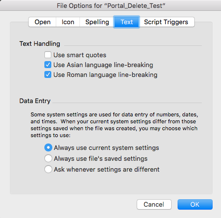

March 26, 201610 yr It sounds like a format issue to me. Have you tried slash marks "/" instead. My filemaker requires dates formatted e.g. "03/22/2016". I've replicated the "?" issue. When i use a script to enter 3-22-2016 I get ?. Try switching to "always use file's saved settings" in File Options.

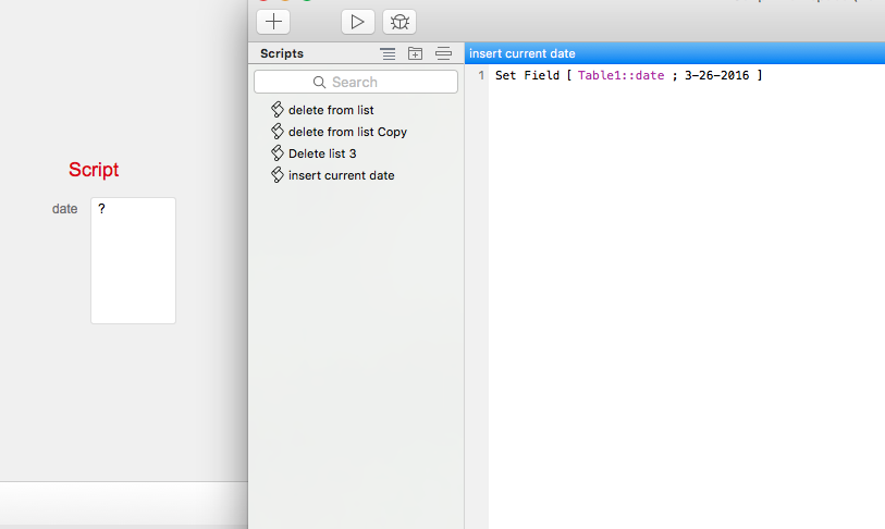

March 26, 201610 yr 15 minutes ago, comment said: That's not possible. Not in the same file. I just tested this, I was able to produce the ? via script and the date (03-26-2016) via typing directly.

March 26, 201610 yr 53 minutes ago, Joshua Willing Halpern said: I just tested this, I was able to produce the ? via script and the date (03-26-2016) via typing directly. I don't see any quotes in your script step. That means you are setting the field to the result of calculating 3 minus 26 minus 2016 - which will return a negative number (-2039). This will of course result in an error. If your file accepts 3-26-2016 as a valid manual entry, then it will also accept: Set Field [ YourTable::Datefield ; "3-26-2016" ] Edited March 26, 201610 yr by comment

March 27, 201610 yr 22 hours ago, comment said: I don't see any quotes in your script step. That means you are setting the field to the result of calculating 3 minus 26 minus 2016 - which will return a negative number (-2039). This will of course result in an error. Yeah, you're right. I'm just trying to replicate OP's problem. It sounds like the format he's using has the year first, e.g. 2016-03-26, which will gives 1987. However, he said he's getting a ? regardless. It's sounding more and more like a date format discrepancy.

March 28, 201610 yr Author OK, The problem solved! Actually, based on below link from FM support, New files and clones of existing files use the current operating system format for date formatting. this means that the file will use date formatting of operating system which was used when you created the file, as file date formatting, no matter what format you choose to be displayed in date fields on layouts. So if you make a file on a computer which uses "2016-03-28" and then move it to a computer which uses "28/03/216", the file still uses "2016-03-28" not matter what format your current system uses or what format you selected for date fields to be shown on layouts. http://www.filemaker.com/help/12/fmp/html/create_db.8.13.html#1028802 So what I did to solve the issue was as below: I did check the format on hosted file by clicking into a date field, it was like "23/03/2016" Then I set my client PC date formatting to match with "23/03/2016" (This is the computer I use for developing my iPad files) After that, I made a clone copy of my iPad file using client PC, now date formats for the iPad file would be like "23/03/2016" which correspond with format of the hosted file. And it syncs properly. At this step, to make sure that this will not happen again, I did set file options to use file formatting instead of current operating system formatting as suggested by Joshua Willing Halpern . From now on, I will make sure that the computer I use to develop client files is set to have the same date format with server computer, to prevent this kind of issues. At the end, I would like to thank you all for your time, efforts, and advises. Siroos,
