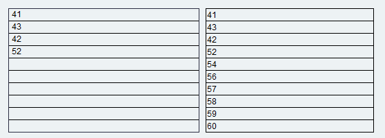

I can't work out why it's still not working. I've attached screenshots. As you can see it is not removing from the right hand portal values that are in the left hand portal.

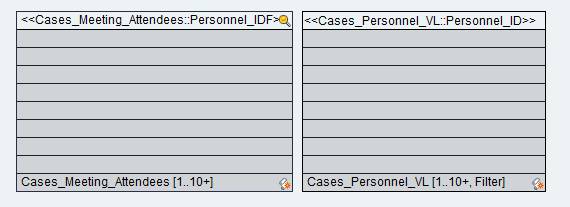

The filter applied to the portal on the right is:
IsEmpty ( FilterValues ( Cases_Personnel_VL::Personnel_ID ; List ( Cases_Meeting_Attendees::Personnel_IDF ) ) )
Got it sorted using IsEmpty ( FilterValues ( List ( Cases_Meeting_Attendees::Personnel_IDF ) ; Cases_Personnel_VL::Personnel_ID ))
I also needed to refresh the portals.
